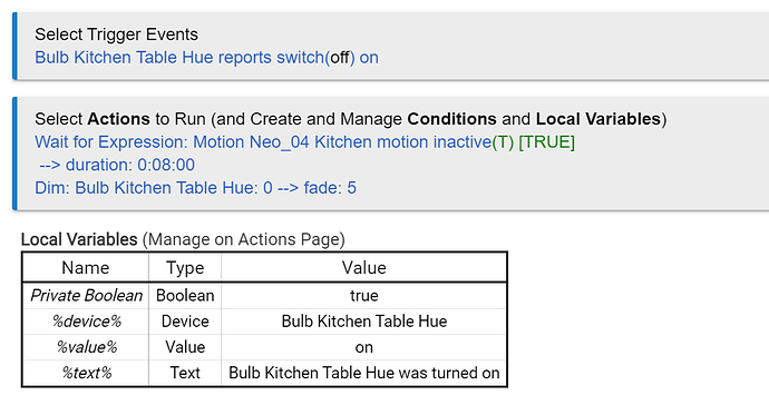

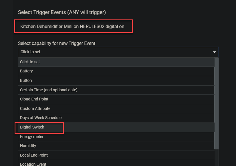

For the trigger I expect you want to use this:

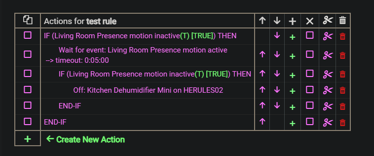

For the Actions, you may want something like this, though I am sure there will be a better way to do this... Also, ignore the devices I have used, the rule does not make sense as an automation.

But with your example, at some point, there had to have been motion because you are waiting for the motion to become inactive.

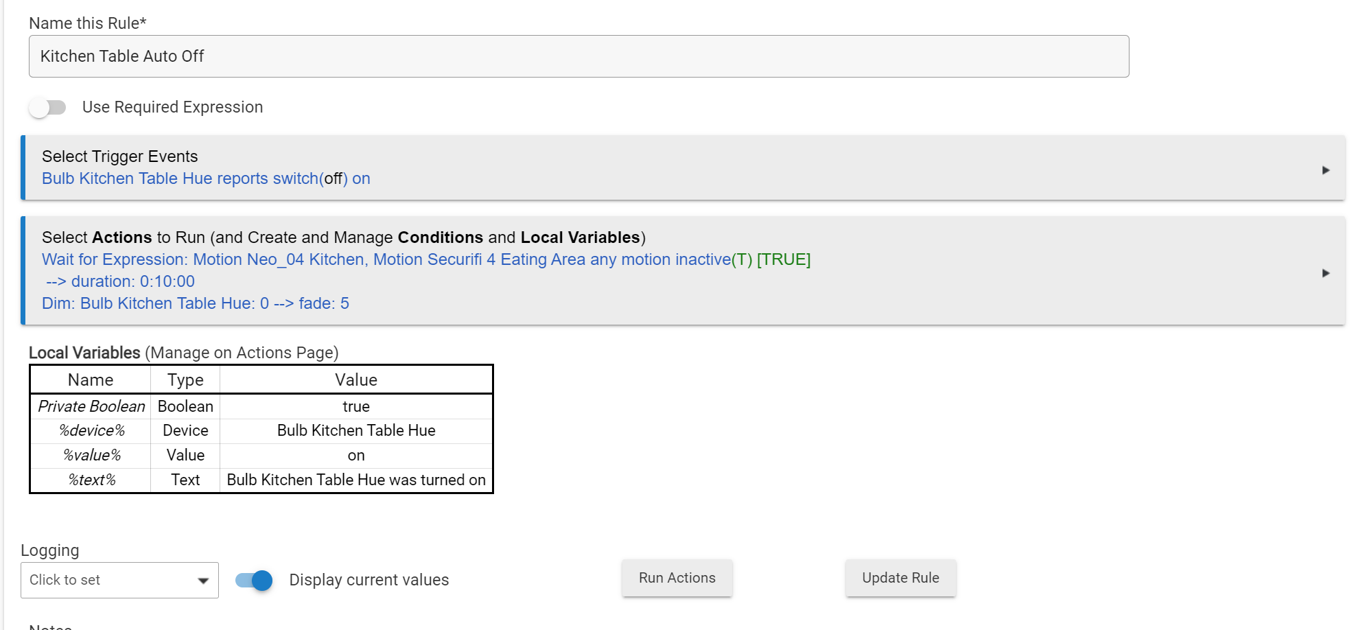

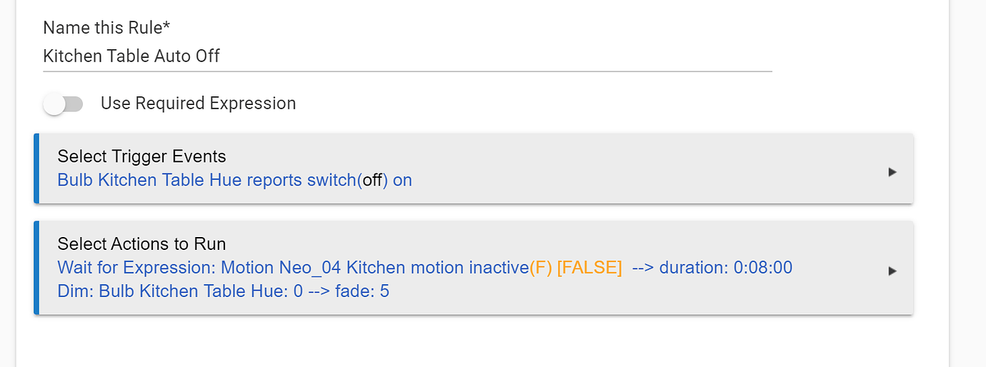

Originally this is what it looked like, and it worked as expected:

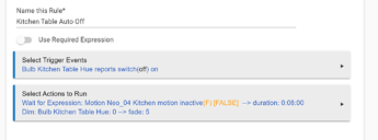

Now it looks like this, and I can't say for sure if it's still working the same or not. :thinking:
Have to wait till everyone goes to bed and test it again.
Empty room, turned it on from a dashboard and 10 minutes later, the rule turned it off.
So it works... I guess :man_shrugging:

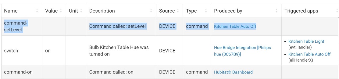

If you lookup the motion sensors you mention in the Wait For Expression, did they activate around the same time you turned on the bulb via the Dashboard? Perhaps within a couple of minutes of turning on the bulb (2 + 8 minute wait)?
