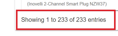

I have *233 devices listed in HE hub #1.
48 are Z-Wave, 60 are Zigbee, 9 Sonos devices, 7 Ecobee devices.
Linked devices are, Philips Hue (65 devices and groups), Lutron Caseta Bridge (4 devices), Harmony hub (6 hubs controlling 15 devices), SmartThings hub controlling 5 window shades.
Is there really then any reason to Link two HE hubs together?
233
