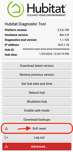

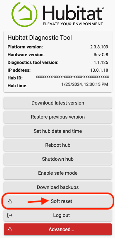

The documentation on the soft reset discusses a full reset via the ADVANCED button on the Diagnostic Tool:
Here to is the information to "force" an update. Since my Diagnostic Tool on my C-7 (current firmware) doesn't look like this I went to the URL noted here: Hubitat Diagnostic Tool | Hubitat Documentation

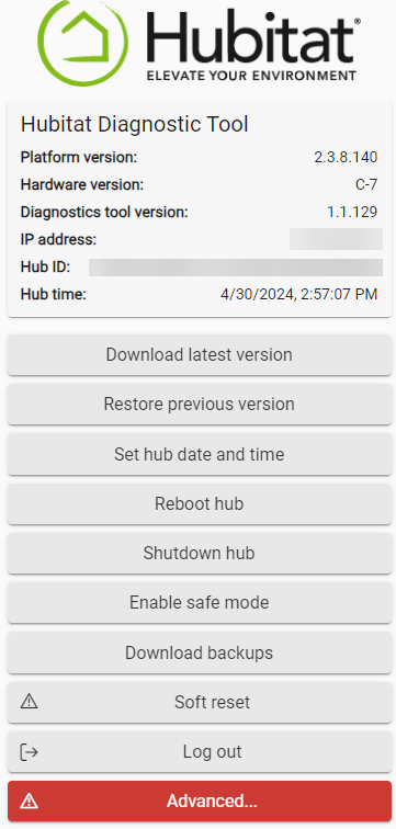

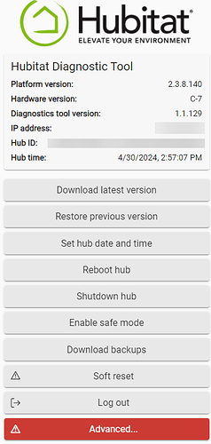

And now http://HUB IP/hub/cloud/updateDiagnosticTool produces:
{"success":true,"message":"Diagnostics tool successfully updated."}
thusly resulting in this:
I guess we're done here. ![]()
