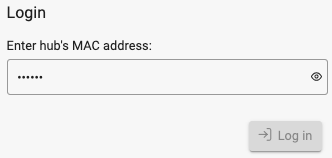

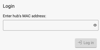

What I imagine is occurring is the MAC address you're entering isn't valid. The dimmed button is what I'd expect if nothing was entered, and it stays that way til a valid MAC is entered.
Empty.
Invalid

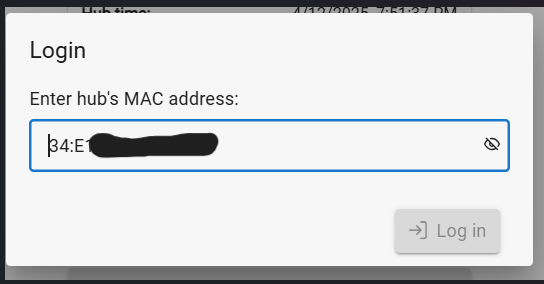

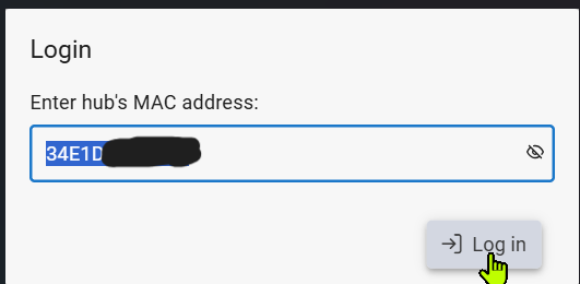

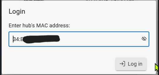

If you copy the MAC from the Hub Details page, or even when you type it in, you may be getting a space at the front-end of the MAC address...like below. Valid MAC, copied from Hub Details, but invalidated by almost impossible to see space before the first character in the MAC.
Correct MAC, but with space in front, log in button disabled:
Space removed, log in button now enabled:
Also, as of a change a while back, you don't have to include the colons, works with or without them, and caps/no caps don't matter.
