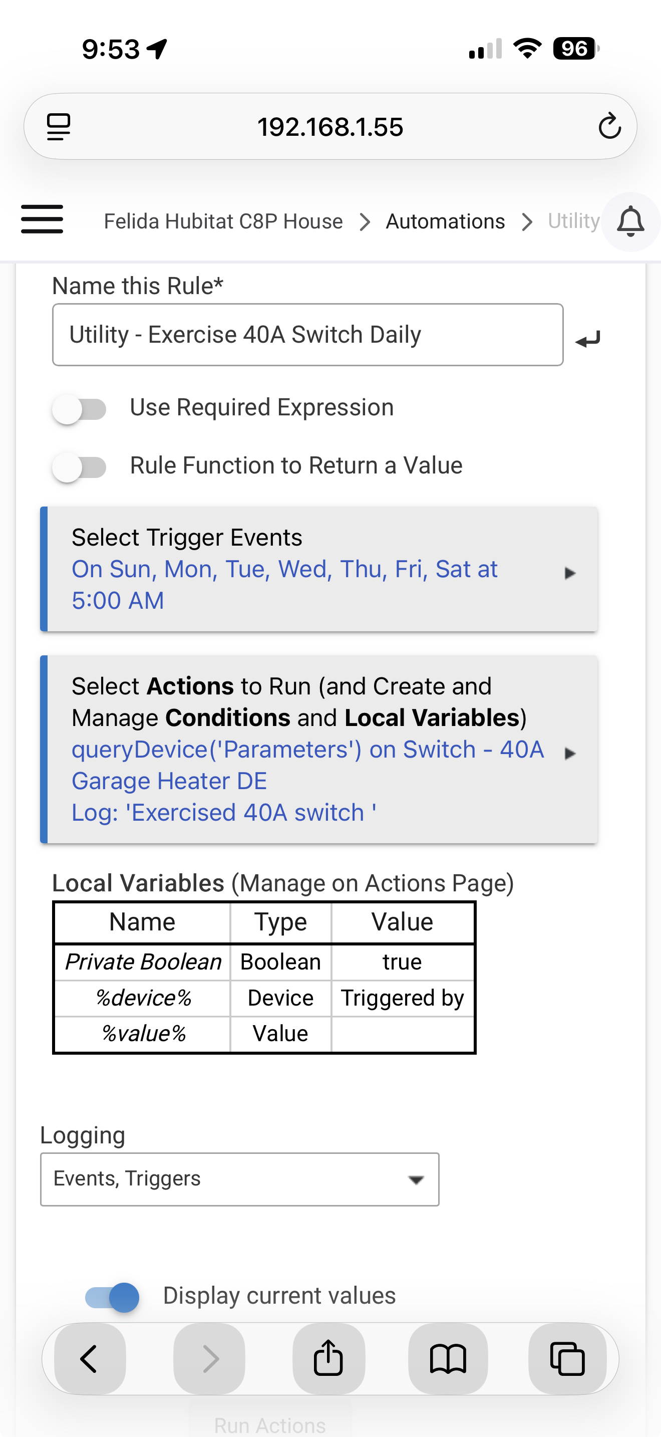

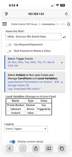

I don’t trigger it much so it occasionally shows up as “inactive“ in some of my device monitoring apps, so I created a rule that runs daily at 5 AM that simply runs this custom action:
