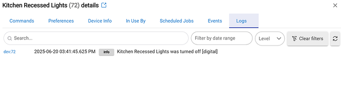

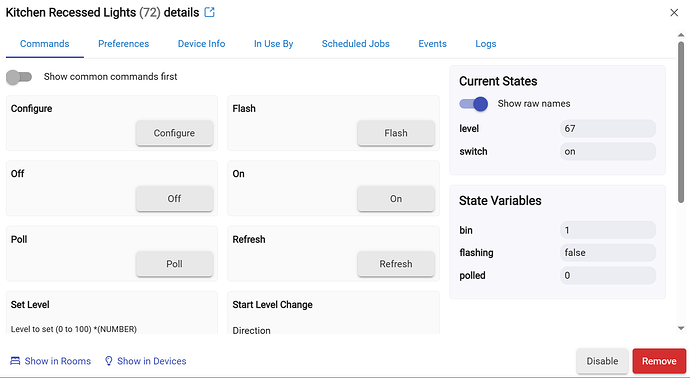

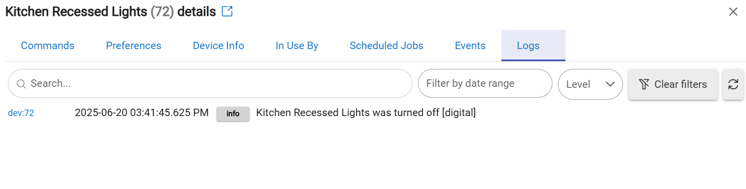

I just physically turned ON the device above with the paddel switch. The lights turn ON, but still show OFF in Hubitat. Also, I just checked the log for this device. There was nothing there and all of a sudden, an entry for an OFF at 3:41PM popped up. It is 4:37 PM !!!! Nothing yet for the ON.

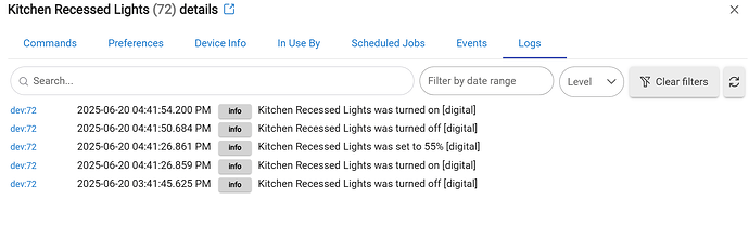

EDIT: I turned them ON, set the level to 55, turned them OFF, turned them back ON. (Using my SharpTools dashboard)Worked fine and now the logs show the activity instantly.
