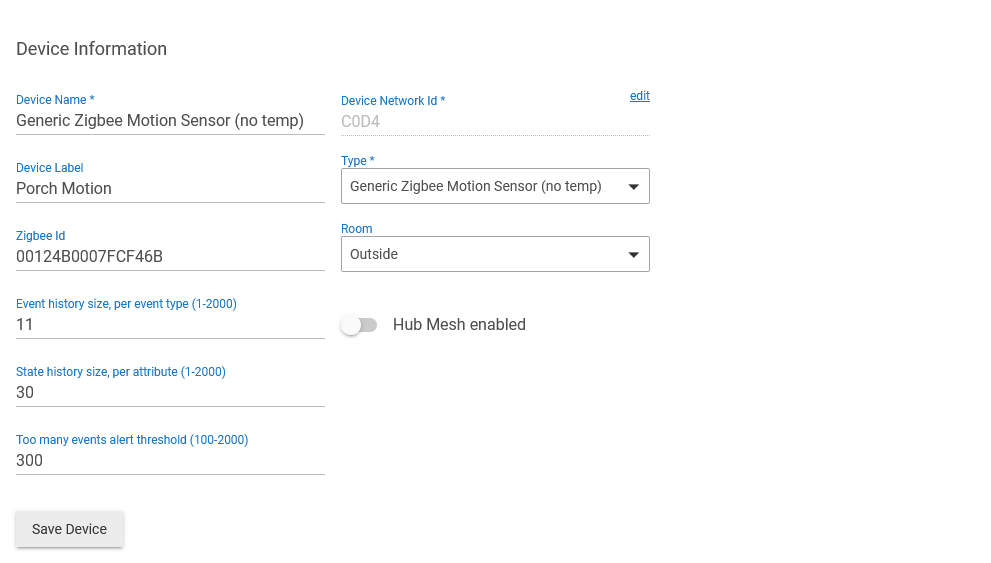

I'm in the middle of troubleshooting some zigbee issues and came across something interesting. One device I'm fighting with I'm using the "Generic Zigbee Motion Sensor (no temp)" driver.
After resetting the device it'll work for a bit then seems to stop. When it quits working, I'll look at the device page and the "Type *" is still set to the correct driver, but is red. Just hiting save turns it blue, and the device seems to work for a bit again.
I'm not sure if this is part of the isssue or just some other unrelated weird quirk I found.

I think I was causing this. It seems to happen with any device page, if you refresh your browser window (F5) while looking at a device, it makes the Type go red. Not sure if that's causing any issues or not however.
I'm starting to lean towards this being unrelated to my zigbee issues.
Been dealing with some Sinope outlets and seeing the same red. As I recall if I SAVE on that Driver screen it goes away....but given what I have been dealing with I have wondered if that red type is telling me something.
Same deal as me. See if you can recreate it like me. Just force refresh a browser tab when looking at a device, and see if it goes red.
I don't know if that actually blows away what driver a device is using or if it's just some quirk in the html
I can't find this topic now, but there was some issue in the past with overlapping text on the device detail page if the driver did something odd in preferences, maybe an "Enum" (dropdown) preference with no selected option? This cause overlap in some of the fields in the Device Information section then, from what I recall. I'm not sure if this was ever addressed at the platform level (a driver certainly could on its own--or a user, assuming there's a logical option to select and you have something without any selection currently), or even if it's the same issue, but it's possible. Maybe someone with the right search terms can find the topic I'm talking about...
In any case, I'd assume this is just a display issue and shouldn't have any effect on your selected driver.
I'm assuming it's just cosmetic as well at this point.
But what's weird and worth noting, if you cause it to turn red and completely close your browser, when you come back, it's still indeed red.
