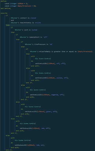

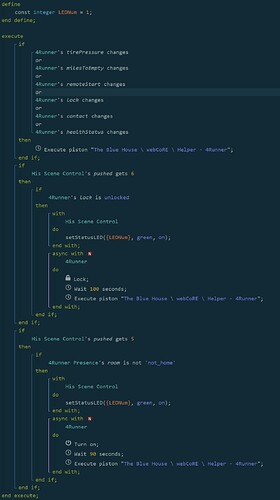

Would you mind sharing some details on how you do that? Looking for some jumping-off points, in my head the logic could be complex but would love an example of someone else doing this... also, what HomeSeer switch are you using?
I have several Homeseer HS-WX300, but good luck finding any out there. They've been discontinued and the replacement hasn't come out yet (if ever). In either case, I use webcore to automate the led's.
For example, when the indoor smoker, which is in the basement, is running, one LED at the dimmer at the top of the stairs will annunciate the current status, and flash if user intervention is required.
For the 4Runner, I have two pistons - one which executes certain conditions on button presses and also triggers on status changes:
This piston executes a second piston which actually illuminates the LED:
