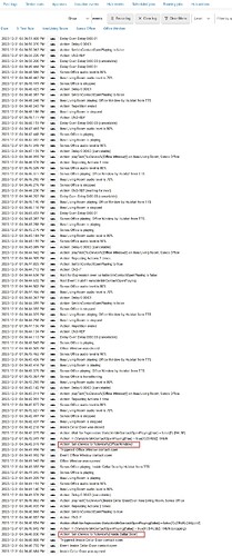

Nor can we without seeing the entire rule, with trigger events being the most notable omission from your screenshots. Logs would also be helpful.
But here's a guess: it's probably that Wait. I don't think this normally changes the value of device except after a timeout (as opposed to an actual event), but variable waits may work differently, or it's possible something changed. Setting the value of a local (or hub) variable to %device% before any Waits and using that variable instead would avoid this issue.
...if, of course, that is the cause, which the above would help show.

This seems to be after the wait, as I mentioned above. You would need to set this value after the trigger but before the wait (or anything else that might change %device%). From your logs, I don't see that happening the second time it's triggered since your expression is true that time and the Wait is reached in that case (I don't see evidence of this happening the first time when it's not).
