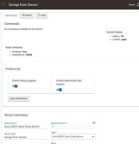

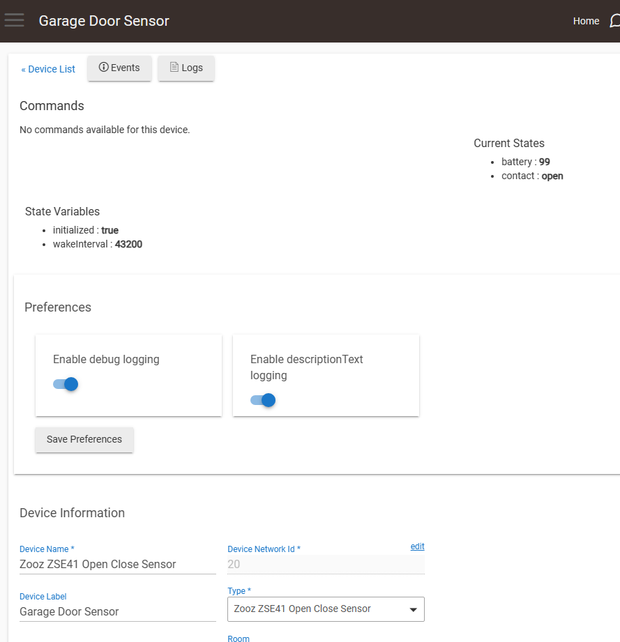

Is the sensor working properly or not? When your light stays red, open up the ZSE41 contact sensor’s Device details page on your Hubitat hub. Is the sensor status correct? Or is it wrong? If the sensor status is correct, then you may need to troubleshoot your automation. If the status is wrong, then you’ll need to troubleshoot the ZSE41 contact sensor. The sensor may be a little picky about the placement of the magnet. Try various positions to see if you can get reliable open and closed status updates. The status updates also require a strong, reliable Z-Wave mesh network. You may want to post your Z-wave settings page to see if anything jumps out to the community members.
Looks like even with the door closed, the contact sensor still shows open. This is the same problem i've had with all three sensors i've used. The previous two were tilt sensors.
