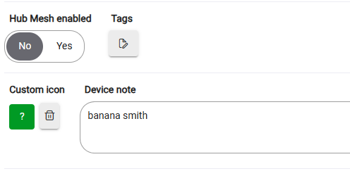

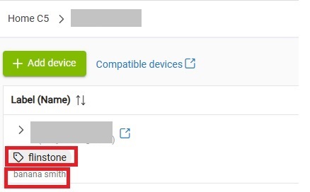

Have you tried notes or tags in each device? They are searchable and show in the UI. I can't tell you the difference in how each works in every scenario, but these are definitely options to explore.
