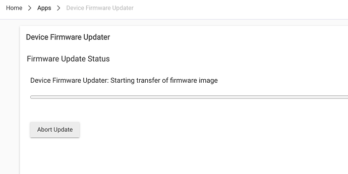

I have a C-8 hub running 2.4.0.151 with about 60 z-wave devices associated with it, most are S2 auth. I am having a problem with the "Device Firmware Updater" app. It seems to work once, then I try and update a second device and it stalls here:
If I reboot the hub and try again, it usually goes through.
