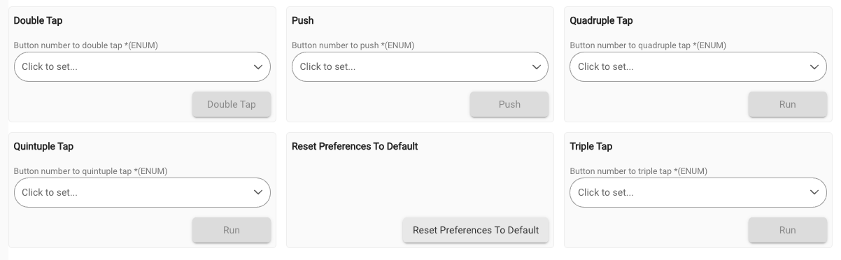

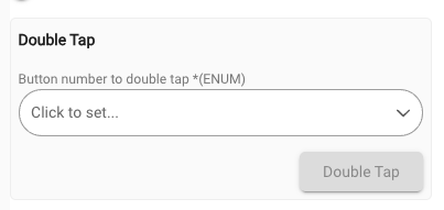

What am I missing here to make the buttons all format the same (i.e. "Push", "Double Tap", "Triple Tap", "Quadruple Tap", "Quintuple Tap"):
command 'push', [ [ name: 'Button number to push *', type: 'ENUM', constraints: BUTTONS ] ]
command 'doubleTap', [ [ name: 'Button number to double tap *', type: 'ENUM', constraints: BUTTONS ] ]
command 'tripleTap', [ [ name: 'Button number to triple tap *', type: 'ENUM', constraints: BUTTONS ] ]
command 'quadrupleTap', [ [ name: 'Button number to quadruple tap *', type: 'ENUM', constraints: BUTTONS ] ]
command 'quintupleTap', [ [ name: 'Button number to quintuple tap *', type: 'ENUM', constraints: BUTTONS ] ]
Mu understanding is that the button name should use the command name split on capital letter, so "doubleTap" -> "Double Tap", "resetPreferencesToDefault" -> "Reset Preferences To Default"?
Why don't the triple / quadruple / quintuple ones work the same way?
Instead they show a "Run" button?

Thanks but that's not really the point here :slight_smile:
These are custom commands that I want to be an ENUM, because I want to limit the selection to the numbers in the list.
The question is why do the buttons on the UI not all format consistently as shown in the image.

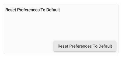

The name / button name on the UI is supposed to come from the command name -
A command "resetPreferencesToDefault":
command 'resetPreferencesToDefault'
gives:
... both the name and the button name are generated based on the capital letter placement in the command.

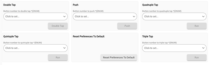

A command "doubleTap":
gives:
... and is also correct, both name ("Double Tap") and button name ("Double Tap") are correct.

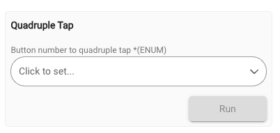

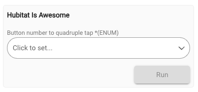

This however, gives the correct name ("Quadruple Tap"), but does not give the correct button name ("Run"):
... it has a button named "Run" instead of "Quadruple Tap".

It doesn't really matter what the command name is, the behaviour is the same:
command 'hubitatIsAwesome', [ [ name: 'Button number to quadruple tap *', type: 'ENUM', constraints: BUTTONS ] ]
Gives name "Hubitat Is Awesome" (expected) and a button name "Run" (IMO unexpected).

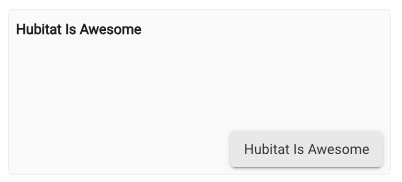

Whereas:
Gives consistent name / button name:

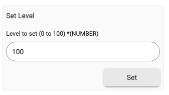

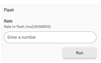

It's inconsistent with some of the "built in" commands too:
Shows name "Set Level" and a button name "Set".
Shows name "Flash" and a button name "Run".

Still seems capability related. Any simple command for me always labels the button as the command name, so hubitatIsAwsome follows that. hubitatIsAwsome(num) shows the run button like any non-capability command seems to.
setLevel is a capability, so it has a set button (but why is it not labeled Set Level is a mystery).
Flash implements either flash() or flash(rate), since rateToFlash is an optional parameter. That might explain why that capability specifically gets just run on the button like any non capability command.
