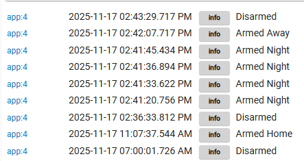

Anyway, today, I set HSM manually (as I sometimes have to do if one of the triggers on a rule doesn't happen - just happens that way due to the sequence of events, no fault of the hub) to Armed Home. This afternoon, one of the triggers fired to disarm HSM. Worked perfectly. However, several minutes later, HSM armed night (4x apparently, according to the logs) and armed away, for no apparent reason (those two status changes are only connected to Mode Manager changes and Mode Manager did not change).
You can see above it disarmed at 7am this morning (Mode change to Day) and where I armed it manually at 11:07. Rule Machine disarmed it at 2:36PM. I have no idea what triggered the next 5 events. I disarmed it at 2:43.
Is it possible to determine what triggered a HSM mode change? Whether it be a manual click on a dashboard or from a keypad, etc.?
I do not think the trigger is stored in the events tab of the app. However, if you remove the filters from the log and look for anything that happened at the same time or just before, you might be able to draw a conclusion (presence returned, mode changed, etc)
