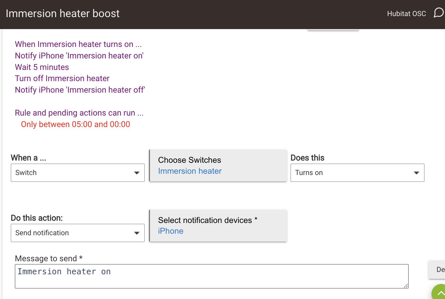

I use @holand.ivar 's excellent Tuya driver to control an immersion heater switch as a timer.
I want to detect when the switch is manually pressed so I can turn it off after a period of time.
I setup a rule to act when it detects the switch is turned on, but it never triggers.
Any ideas or alternative solutions?

Here are some trouble shooting steps to try. First, turn on logging for the rule and the device. For debugging change the wait time to 1 minute and remove the only between time restriction.
When you turn on the immersion heater switch through the device page, does the rule work?

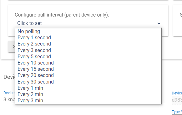

Hi @PaulB, these driver are polled. In the device setting you need to enable polling of the device status. There is unfortunately no way of getting the tuya device to actively send messages to the Hubitat hub, the hub needs to poll the device for its status. Essentially what the polling setting does is that it sets up a schedule to run the status() function.
If you open your device settings you should be able to see the below setting:
I would not recommend polling the device too often as it puts a load on your network and hub. My recommendation is to poll often on things that needs to have a quick response and limit those who do not really need immediate feedback.
