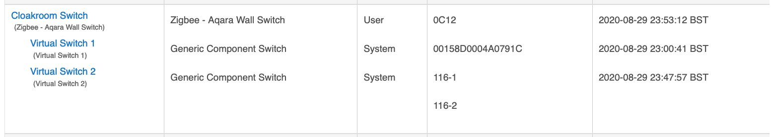

Starting with the 3-key QBKG25LM, it paired very enthusiastically as this:
- endpointId: 02
- buttonCombos: 0
- application:
- driver: v0.8.1.0814
- model: lumi.switch.l3acn3
- physicalButtons: 0
- manufacturer:

Next is the 2-key QBKG22LM , again no issues pairing.
- endpointId: 01
- buttonCombos: 1
- application: 1C
- model: lumi.switch.b2lacn02
- physicalButtons: 2
- manufacturer: LUMI
dev:1162020-08-29 23:53:12.601 infoSending temperature event (Temperature: 15.0 °C)

It was less clear what was going on here and although the 22LM appears to be a 25LM with one fewer key, it's behaviour seems different.
First of all, the left button on all my 22LM switches controls L2 while the right controls L1, which is backwards to how you'd expect. It's also wrong in comparison to the 25LM, where from left to right the keys control L1, L2 and L3 as normal.
Though I saw reports for all single presses, double presses, triple presses and holds seemed to appear simply as multiple single presses. There may be a hold message, but the 're-pair' timeout seems shorter, so on one occasion I reset the switch instead of triggering a hold.

dev:1162020-08-30 00:06:48.029 errorjava.lang.NullPointerException: Cannot invoke method parse() on null object on line 643 (parse)
dev:1162020-08-30 00:06:48.012 infoOn/Off Button press - description:read attr - raw: 0C12060006100000100000001001, dni: 0C12, endpoint: 06, cluster: 0006, size: 10, attrId: 0000, encoding: 10, command: 0A, value: 0000001001 | parseMap:[raw:0C12060006100000100000001001, dni:0C12, endpoint:06, cluster:0006, size:10, attrId:0000, encoding:10, command:0A, value:00, clusterInt:6, attrInt:0, additionalAttrs:[[value:01, encoding:10, attrId:0000, consumedBytes:4, attrInt:0]], valueParsed:false]
dev:1162020-08-30 00:06:47.596 errorjava.lang.NullPointerException: Cannot invoke method parse() on null object on line 643 (parse)
dev:1162020-08-30 00:06:47.578 infoOn/Off Button press - description:read attr - raw: 0C12030006160000100000F02300120C03, dni: 0C12, endpoint: 03, cluster: 0006, size: 16, attrId: 0000, encoding: 10, command: 0A, value: 0000F02300120C03 | parseMap:[raw:0C12030006160000100000F02300120C03, dni:0C12, endpoint:03, cluster:0006, size:16, attrId:0000, encoding:10, command:0A, value:00, clusterInt:6, attrInt:0, additionalAttrs:[[value:030C1200, encoding:23, attrId:F000, consumedBytes:7, attrInt:61440]], valueParsed:false]
dev:1162020-08-30 00:06:47.572 infoOn/Off Button press - description:read attr - raw: 0C12020006160000100000F0237A120C03, dni: 0C12, endpoint: 02, cluster: 0006, size: 16, attrId: 0000, encoding: 10, command: 0A, value: 0000F0237A120C03 | parseMap:[raw:0C12020006160000100000F0237A120C03, dni:0C12, endpoint:02, cluster:0006, size:16, attrId:0000, encoding:10, command:0A, value:00, clusterInt:6, attrInt:0, additionalAttrs:[[value:030C127A, encoding:23, attrId:F000, consumedBytes:7, attrInt:61440]], valueParsed:false]
dev:1162020-08-30 00:06:37.965 errorjava.lang.NullPointerException: Cannot invoke method parse() on null object on line 643 (parse)
dev:1162020-08-30 00:06:37.945 infoOn/Off Button press - description:read attr - raw: 0C12060006100000100000001001, dni: 0C12, endpoint: 06, cluster: 0006, size: 10, attrId: 0000, encoding: 10, command: 0A, value: 0000001001 | parseMap:[raw:0C12060006100000100000001001, dni:0C12, endpoint:06, cluster:0006, size:10, attrId:0000, encoding:10, command:0A, value:00, clusterInt:6, attrInt:0, additionalAttrs:[[value:01, encoding:10, attrId:0000, consumedBytes:4, attrInt:0]], valueParsed:false]
dev:1162020-08-30 00:06:37.618 errorjava.lang.NullPointerException: Cannot invoke method parse() on null object on line 641 (parse)
dev:1162020-08-30 00:06:37.592 infoOn/Off Button press - description:read attr - raw: 0C12030006160000100100F02300120C03, dni: 0C12, endpoint: 03, cluster: 0006, size: 16, attrId: 0000, encoding: 10, command: 0A, value: 0100F02300120C03 | parseMap:[raw:0C12030006160000100100F02300120C03, dni:0C12, endpoint:03, cluster:0006, size:16, attrId:0000, encoding:10, command:0A, value:01, clusterInt:6, attrInt:0, additionalAttrs:[[value:030C1200, encoding:23, attrId:F000, consumedBytes:7, attrInt:61440]], valueParsed:true]
dev:1162020-08-30 00:06:37.587 infoOn/Off Button press - description:read attr - raw: 0C12020006160000100100F0237A120C03, dni: 0C12, endpoint: 02, cluster: 0006, size: 16, attrId: 0000, encoding: 10, command: 0A, value: 0100F0237A120C03 | parseMap:[raw:0C12020006160000100100F0237A120C03, dni:0C12, endpoint:02, cluster:0006, size:16, attrId:0000, encoding:10, command:0A, value:01, clusterInt:6, attrInt:0, additionalAttrs:[[value:030C127A, encoding:23, attrId:F000, consumedBytes:7, attrInt:61440]], valueParsed:true]
dev:1162020-08-30 00:06:21.286 infoOn/Off Button press - description:read attr - raw: 0C12020006160000100000F0237A000007, dni: 0C12, endpoint: 02, cluster: 0006, size: 16, attrId: 0000, encoding: 10, command: 0A, value: 0000F0237A000007 | parseMap:[raw:0C12020006160000100000F0237A000007, dni:0C12, endpoint:02, cluster:0006, size:16, attrId:0000, encoding:10, command:0A, value:00, clusterInt:6, attrInt:0, additionalAttrs:[[value:0700007A, encoding:23, attrId:F000, consumedBytes:7, attrInt:61440]], valueParsed:false]
dev:1162020-08-30 00:06:21.180 infoPower Cluster 0006 catchall - description:catchall: 0104 0006 02 01 0040 00 0C12 00 00 0000 0B 01 0000 | parseMap:[raw:catchall: 0104 0006 02 01 0040 00 0C12 00 00 0000 0B 01 0000, profileId:0104, clusterId:0006, clusterInt:6, sourceEndpoint:02, destinationEndpoint:01, options:0040, messageType:00, dni:0C12, isClusterSpecific:false, isManufacturerSpecific:false, manufacturerId:0000, command:0B, direction:01, data:[00, 00]]
dev:1162020-08-30 00:06:19.732 debugsendZigbeeCommands(cmd=[he cmd 0x0C12 0x02 0x0006 0x00 {}, delay 200])
dev:1162020-08-30 00:06:19.726 debugcomponentOff() from 116-2
dev:1162020-08-30 00:06:14.064 infoOn/Off Button press - description:read attr - raw: 0C12020006160000100100F02379000007, dni: 0C12, endpoint: 02, cluster: 0006, size: 16, attrId: 0000, encoding: 10, command: 0A, value: 0100F02379000007 | parseMap:[raw:0C12020006160000100100F02379000007, dni:0C12, endpoint:02, cluster:0006, size:16, attrId:0000, encoding:10, command:0A, value:01, clusterInt:6, attrInt:0, additionalAttrs:[[value:07000079, encoding:23, attrId:F000, consumedBytes:7, attrInt:61440]], valueParsed:true]
dev:1162020-08-30 00:06:13.957 infoPower Cluster 0006 catchall - description:catchall: 0104 0006 02 01 0040 00 0C12 00 00 0000 0B 01 0100 | parseMap:[raw:catchall: 0104 0006 02 01 0040 00 0C12 00 00 0000 0B 01 0100, profileId:0104, clusterId:0006, clusterInt:6, sourceEndpoint:02, destinationEndpoint:01, options:0040, messageType:00, dni:0C12, isClusterSpecific:false, isManufacturerSpecific:false, manufacturerId:0000, command:0B, direction:01, data:[01, 00]]
dev:1162020-08-30 00:06:13.111 debugsendZigbeeCommands(cmd=[he cmd 0x0C12 0x02 0x0006 0x01 {}, delay 200])
dev:1162020-08-30 00:06:13.106 debugcomponentOn() from 116-2
dev:1162020-08-30 00:06:03.249 debugsendZigbeeCommands(cmd=[he cmd 0x0C12 0x01 0x0006 0x01 {}, delay 200])
dev:1162020-08-30 00:06:03.245 debugcomponentOn() from 116-1
dev:1162020-08-30 00:06:01.685 debugsendZigbeeCommands(cmd=[he cmd 0x0C12 0x01 0x0006 0x00 {}, delay 200])
dev:1162020-08-30 00:06:01.679 debugcomponentOff() from 116-1
dev:1162020-08-30 00:05:59.102 debugsendZigbeeCommands(cmd=[he cmd 0x0C12 0x01 0x0006 0x01 {}, delay 200])
dev:1162020-08-30 00:05:59.096 debugcomponentOn() from 116-1
dev:1162020-08-30 00:04:45.237 infoSending temperature event (Temperature: 15.0 °C)
dev:1162020-08-30 00:04:45.233 debugKNOWN event (Xiaomi/Aqara specific data structure) - description:read attr - raw: 0C120100005A01FF42296410006510006E20006F20000121E40C03280F0521090008211C360A2191FC9923000000009B210000, dni: 0C12, endpoint: 01, cluster: 0000, size: 5A, attrId: FF01, encoding: 42, command: 0A, value: 296410006510006E20006F20000121E40C03280F0521090008211C360A2191FC9923000000009B210000 | parseMap:[raw:0C120100005A01FF42296410006510006E20006F20000121E40C03280F0521090008211C360A2191FC9923000000009B210000, dni:0C12, endpoint:01, cluster:0000, size:5A, attrId:FF01, encoding:41, command:0A, value:[raw:[openClose:00, switch2:00, unknown10:00, unknown11:00, battery:0CE4, deviceTemperature:0F, RSSI_dB:0009, unknown3:361C, routerid:FC91, gestureCounter3:00000000, unknown9:0000], openClose:false, switch2:false, unknown10:0, unknown11:0, battery:3300, deviceTemperature:15, RSSI_dB:9, unknown3:13852, routerid:64657, gestureCounter3:0, unknown9:0], clusterInt:0, attrInt:65281]
Remote operation of virtual switch 1 doesn't work, but operating virtual switch 2 does and it controls the left key, which in turn is controlling L2. So there's a sort of twisted logic in there.
