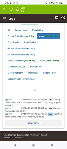

Ok so I just ran another test for away and nothing changed even for heat.
It seems to be using the thermostat's presets for your apps mode change. Meaning whenever the app sends command to change to heat, cool, auto it will use the numbers from the comfort settings heat and cool setpoints. Not sure if I explained that well enough
This is what the thermostat does ALWAYS - it gets its setpoints from the currently select comfort setting. When you change setpoints, you should be changing the ones for the selected comfort setting.
Right so it's not changing the set points for the selected mode
After extensive additional testing, I am unable to recreate your issue - using the 1.8.25 version of Smart Mode (at al), the helper correctly changes the setpoints for the "middle" range, whether I specify both or only one.
I am at a loss to explain why yours isn't working.
I suggest perhaps that you should recreate your Helper instance from scratch, to see if that helps clear things up.
Well re-created everything from scratch and its working perfectly. thats crazy. sorry i keep bothering you.

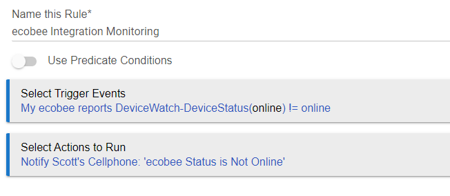

Can you post your rule?
I had not looked at it in awhile and wrote it some time ago. I just added the two EcoBee reports triggers, I originally just had it running every hour.
I am not using the Ecobee Suite, just the built-in integration and this is what I setup yesterday to notify me on any future failures.
Screenshot 2021-09-25 122647
