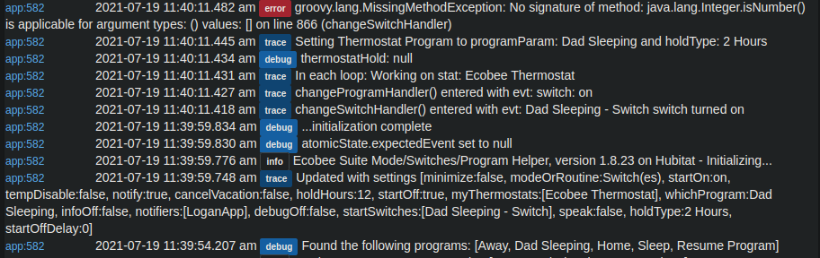

I've hit a snag. I've gotten a couple helpers set up. In short, when I go to sleep, my hub receives a Maker API message, which turns on a "dad sleeping" switch. Ecobee suite sees the switch and changes the thermostat to a custom comfort profile, coincidentally named "dad sleeping," with a hold for 1 hour. "Dad sleeping switch turns back off. But the thermostat wasn't changing. Error in the log is:
I went in to the app code and changed the "isInteger" to "toInteger" and that solved the dad sleeping issue, the hold successfully took for the one hour. But then that messed up my "mode becomes away" to set the away profile. I don't remember the exact error and have already repaired the package, but it involved line 866 of the routines helper and "indefinite is invalid." After repairing the installation, the indefinite away hold when I'm away is working again, but now "Dad Sleeping" is throwing the above error again.

What did you set the “holdHours” to in the helper (it appears to be blank/empty/null).
That's definitely something I should have mentioned in the narrative. I had it set to 1 hour and have also tried 2.
I was curious why it showed the value as being what appears to be an invalid character. I've also tried copy/pasting a "1" from my text editor in case there was some stupid formatting being carried over, no change.
Try changing lines 831 & 832 from:
if (settings.holdHours && settings.holdHours.isInteger()) {
sendHoldType = settings.holdHours
to:
if (settings.holdHours?.isNumber()) {
sendHoldType = settings.holdHours.toInteger()
Sorry for the delay. I tried to apply your code last night on mobile while I was in bed, but couldn't get the window to stop jumping back up to the top. Just applied it via PC to no avail. Same error, except it specifies the "isNumber" now instead of "isInteger" with the same "[]" as being the value.
There's a clue though... I thought that was single invalid character sign, but that's actually an open and close bracket... I'll do some more playing around in the meantime.
Not sure if this helps at all, but I tried changing the hold hours to 12 and see in the logs that it at least properly records the number at some point, but apparently that value isn't getting passed along?

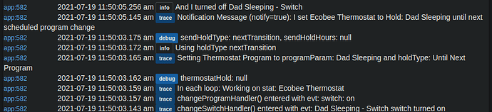

Update - More information
I changed the hold time to "2 hours" explicitly, rather than the "set number of hours" and got the following in the logs when I tried to activate the switch and routine:
After changing the hold to "til next program" I got these logs and it completed successfully.
Update again - Went back to rule machine to accomplish the goal. Rather than having it turn on the "dad sleeping" switch to activate the routine via Ecobee suite, I just send the custom command to change program with 1 hour hold parameter and the thermostat takes it.

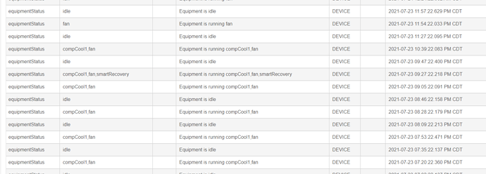

I've been searching through everything I can find on the Ecobee suite. I was hoping to be able to change the volume on a Roku sound bar when the fan is running on our HVAC. Unfortunately the native Ecobee integration doesn't get updates on the system status. Would I be able to do this with Ecobee Suite if I changed over to it? TIA.
The "equipmentStatus" attribute would be the go to for state of the HVAC unit being controlled, the value of this can be used for automations. Just parse out the word "fan"
The native device handler reports thermostatOperatingState; any non-idle value means the fan is running (unless you have steam radiators). But it doesn’t poll often enough to give you updates in a timely manner.
With Ecobee Suite, set the polling frequency to 1 minute. Fan updates can be up to a minute delayed, so it’s still not perfect.
