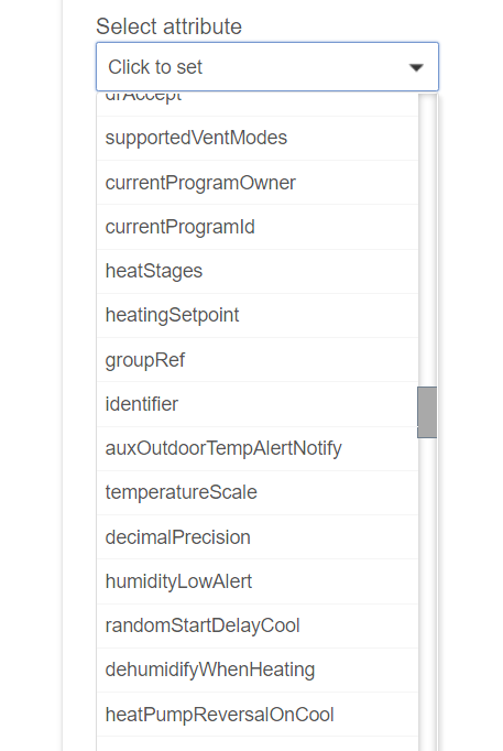

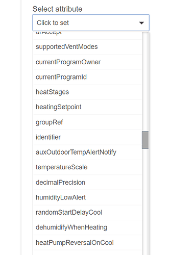

Not sure the best place to pot an improvement request so I'm happy to post elsewhere, email, etc.
Obvious Ecobee has maaaany attributes to look for or call, yet the list of attributes is not in alphabetical order when setting a custom attribute - making it really tricky to find what you need. Checking other devices it seems that this isn't the case - so I'm guessing this is a driver issue, but I'll confess I know zilch about Groovy, developing for HE, etc.
That's funny you should mention as I was just going through this yesterday and I wondered the same thing.
I was building a graph using my thermostat's temp and humidity. Looking through that list to find the parameter I wanted was a tedious task.
All of the exposed attributes are in fact defined in my code in alphabetical order, and I can find no rhyme or reason for the order that they are presented in Rule Machine (or anywhere else).
Perhaps an enhancement request to the Hubitat team is the solution...
Interesting. I wonder if there is some additional key that can be added to the list to define the order (or some additional option/parameter to do it by alpha). Only suggesting there may be something already there since other devices have theirs in alpha order - though of course it could totally be an HE bug preventing this in your case. Will poke around and see where I can suggest this to the HE team. Still new to this.
I am pretty sure that these "other devices" don't present 300+ attributes - and perhaps no custom attributes at all. The core set of attributes are defined by Capabilities, which likely define their related attributes in internal structures. I also use Capabilities, but an Ecobee Suite Thermostat has 9 different Capabilities, plus the 300+ custom attributes.
If you can provide me with a working example of a Custom Device Handler that has a reasonably large number of custom attributes, I'll be happy to review it for ideas.
