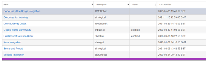

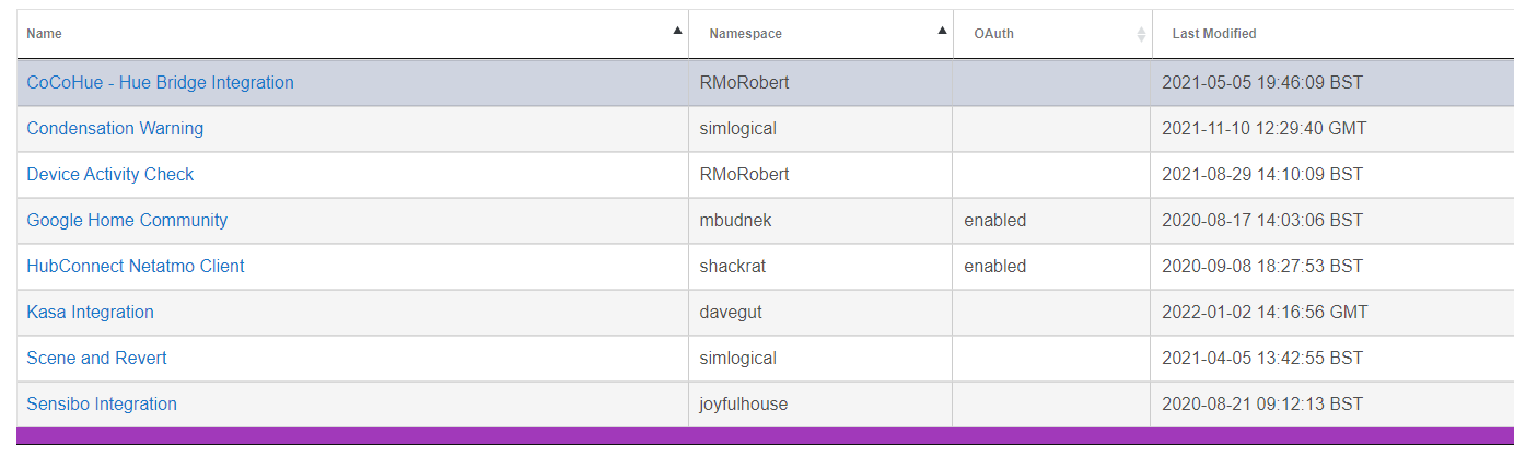

Check the Apps Code. You may have two versions installed.
Dave
Yep as per post #1626 I know that isn't in your code, I already checked. The only possibility left is something in the hub's cache
Dave
It says modified just now but that's just cos I saved it again to make sure I'd saved it. I also checked to make sure I hadn't appended or inserted rather than overwriting

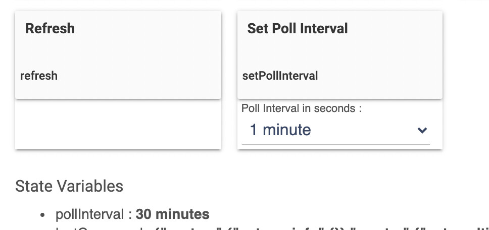

Super minor issue -- I changed the polling interval for my 2 energy plugs and in both cases nothing happens when I hit "set polling interval" button. I have to do a page refresh to see the new polling time show up under the 'state variables' section. It did work so this isn't really an issue - just something minor I noticed.
That is a Hubitat design of not updating the State Variables except on a save preferences or a refresh of the browser.
