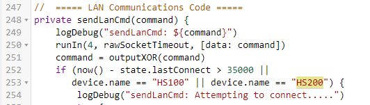

I figured out the issue. I did see the warning come up once saying something about the device name being wrong. I thought it was saying the first 5 should be the model, did not realize it was saying the device name should ONLY be the first 5 of the model. Originally I had the device.name "Kasa HS200" and I switched it to "HS200 Kasa" when I saw the error. It did not come up again that I noticed so I thought it was happy. Today I just discovered in the code it is doing an == check against that looking specifically for the HS200 to do an extra step which was getting missed. On the retry however I can see in the logs it was doing that extra step (attempting to connect...).
Might I suggest a more persistent and more clear warning in the log? Or could also change the == to a regex match (no quotes needed): device.name ==~ /.*HS200.*/
Either way I got it fixed and understand it now for myself.
I appreciate the look and that would cause the problem. Error message will change in next release.
