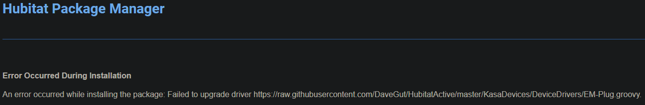

HPM says there's an update but throws an error when I try to update the package. Anything I can do to fix this?
Just tested, no issues. I do not know what may have occurred.

The update still doesn't seem to work. Logs say that it's a server error. Any ideas on what I might be able to do to resolve this?
If you are using HPM, that is NOT my package and I have no Idea what is wrong. Go to the Hubitat Package Manager thread for guidance.
You can do a manual update using the link provided in the driver/app and the import function of within the editor.
