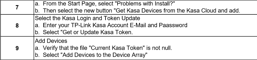

Are you using the Built-in or custom app? (if custom there is something to try).
Cloud or Local control?
If LAN, did you assign static IP addresses - as stated in the installation instructions?
Community Integration available option. May not work on the built-in app.
Suggestion - Run the integration app.
If your device is cloud, go to cloud installation and update username and password - this will get a new token.
If your device is LAN connected, start the install process. After the device select page displays, this will update the device IP addresses (if the devices are on your LAN).
There is also a tool to list the devices. This looks for the devices on the LAN and lists them.
Kasa Integration Utilities - Test Devices LAN Status.... This will list the devices that are on the lan - regardless of installation.
