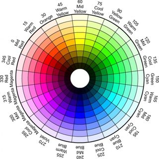

Color is a circle. There are no sides. ![]()

These bulbs trip me up sometimes.. it's like they change identities when switching from CT to RGB
True.. that's why it's 0 to 360.. But on red is split
This scale doesn't quite follow what the bulb does. For instance a 0=3.6 does show red. A 3=10.8 is actually Orange. A 9=32.4 is actually Yellow. Just a few examples. To get an exact color in an event you would have to use custom color and a number each time. Some of the other colors do fall within your ranges but the exact color is a single number.
0=0
0 * 3.6 is still 0
As to the accuracy of the names... I stole the color name code from the example code on hubitat public github
OK 1=3.6. My bad. I am going to create an event and pick the colors in HE and see how they compare.
