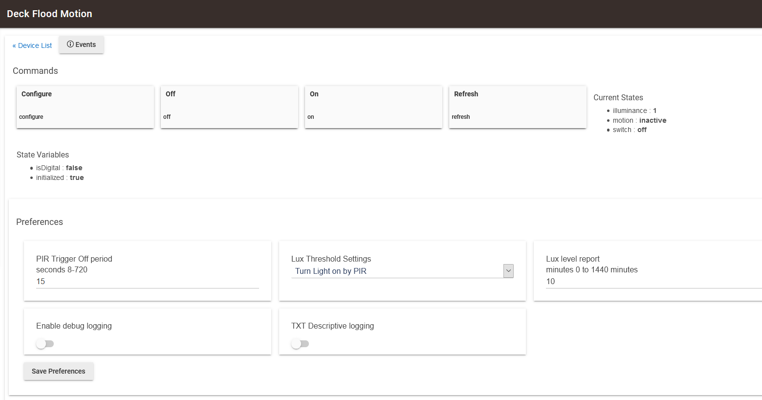

Yes! I figured this out earlier today but it's nice to have confirmation. The state variable "isdigital" in the device page is still showing as false but from my limited toying with it while setting the motion sensor this morning it appears to be working via zwave commands.
Ha.. Most of my community drivers took the verbiage right from the z-wave certification page for the devices.
For me, it is kind of funny - I was already doing this as I had it set to "Always don't" and I control the on and off via the hub... with HE, its so fast (and this device is fast, too) I forgot the hub was telling the lights to turn on after the PIR sensed motion as opposed to the sensor directly controlling the lights... I wasn't even drinking when I wrote the message above asking if bcopeland could add this.
state "isDigital" should turn true if you turn the light on or off using HE.
Thank you, was wondering about the isDigital status.
It's been about 48 hours and the zigbee bulbs are operating flawlessly with motion detection and via the inovelli switch with the internal relay off (no power cut at the switch) so all is right with the world,,well, in this case at least. However, the isdigital is still showing as false.
That is the local device turning the light on/off with motion. Based on what I see in the driver isDigital will set to true if you control the light through HE (aka hit the On or Off button in the interface or use it in a rule). However once the light itself (PIR) turns the device on or off it will go back to false.
What are you doing with that state variable that you are looking for it to be true? It really has no bearing on anything.
At this point, with it doing what I want it to do, I think nothing is needed regarding the isdigital state. Original post included it as I really had no idea how this thing worked and added it to my last post just as an fyi in case others stumble across this post.
Shout out to @gavincampbell @mark @jrfarrar @bcopeland @dman2306 for the assist!
My isDigital states also show false on all five of my devices. I have HE turn the light on when the particular PIR detects motion and I have them set to "Always don't turn on light". So I guess that means that state isn't presented correctly, but it works as expected which is good.
Well, looking at the code again..it seems it DOES get set when turned on/off by HE...but then reset because it then sends the command to the device which then reports back...and sets it back.
