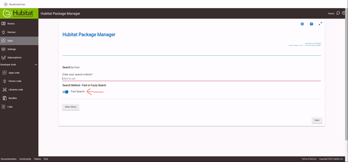

If you aren't seeing the Fast search option I would suggest you check that you are running the latest version of HPM. I have included a screen shot of the switch below.
I reached out to csteel to try to figure out why some folks were having problems finding the app. As it turns out the "Fast Search" option was something he added and the legacy Fuzzy search method requires upkeep by the previous maintainer of HPM. I would suggest you make sure you have this option, If not update HPM and then make sure it is enabled going forward.

You are correct on the update. I was running 1.8.3 that I found online - I now have 1.8.7 and the fast search is showing up. Thanks!
