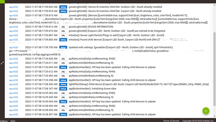

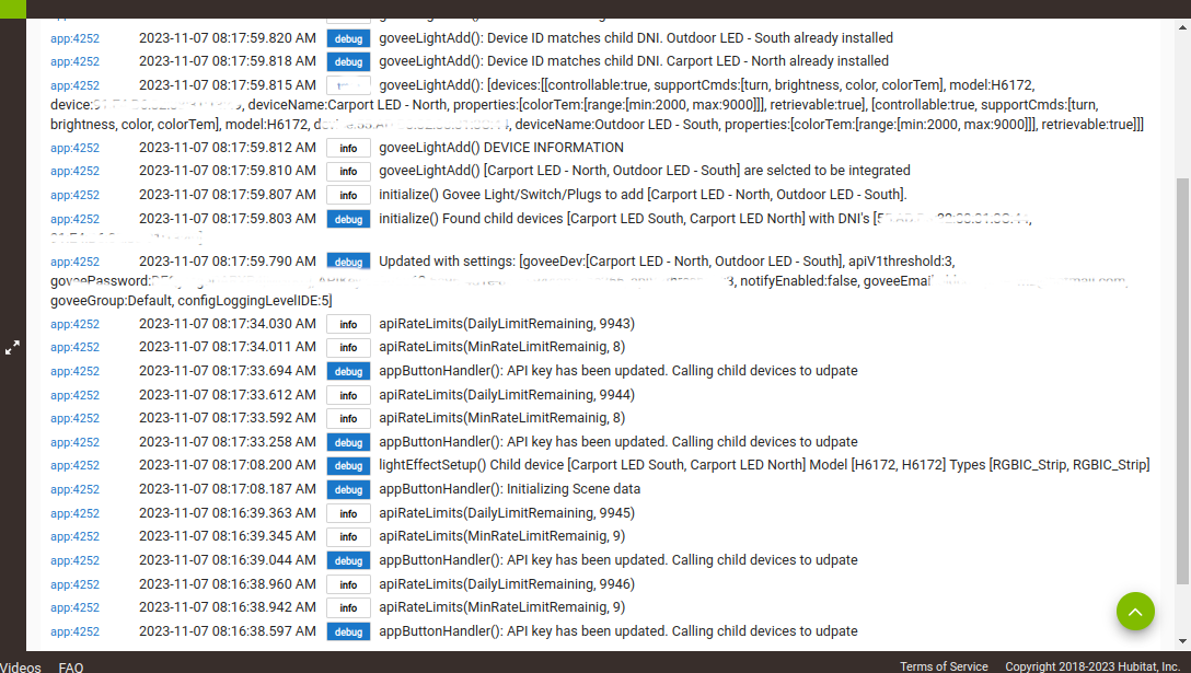

Good morning, Craig. DIY effects is now populated. That is fixed. Regular scenes is empty. I tried both update methods listed above even though I was already on .45 and still no regular scenes
What can I do to help?
Here are the trace logs from Reload Preload Scene Data & Refresh Device Scene Awareness.
So .45 worked and i was able to get the premade scenes to show up, and i think the diy for atleast one device showed up.
updated to the latest .46 and at first the diy came in, but the preloaded scenes all disappeared. Now i cant get either the diy or scenes to show on any device.

app:22642023-11-07 07:51:18.729debugappButtonHandler(): Initializing Scene data
app:22642023-11-07 07:51:14.458infoapiRateLimits(DailyLimitRemaining, 4845)
app:22642023-11-07 07:51:14.429infoapiRateLimits(MinRateLimitRemainig, 6)
app:22642023-11-07 07:51:14.023debugappButtonHandler(): API key has been updated. Calling child devices to udpate
app:22642023-11-07 07:51:13.883infoapiRateLimits(DailyLimitRemaining, 4846)
app:22642023-11-07 07:51:13.854infoapiRateLimits(MinRateLimitRemainig, 7)
app:22642023-11-07 07:51:13.437debugappButtonHandler(): API key has been updated. Calling child devices to udpate
app:22642023-11-07 07:51:13.298infoapiRateLimits(DailyLimitRemaining, 4847)
app:22642023-11-07 07:51:13.269infoapiRateLimits(MinRateLimitRemainig, 7)
app:22642023-11-07 07:51:12.934debugappButtonHandler(): API key has been updated. Calling child devices to udpate
app:22642023-11-07 07:51:12.929infoapiRateLimits(DailyLimitRemaining, 4848)
app:22642023-11-07 07:51:12.803infoapiRateLimits(MinRateLimitRemainig, 7)
app:22642023-11-07 07:51:12.783infoapiRateLimits(DailyLimitRemaining, 4849)
app:22642023-11-07 07:51:12.754infoapiRateLimits(MinRateLimitRemainig, 7)
app:22642023-11-07 07:51:05.662infoinitialize() No appliances to add
app:22642023-11-07 07:51:05.658debuglightEffectSetup() Child device [Blakes Desk Rope, Back Eaves Lights, Front Eaves Lights] Model [H61C3, H705C, H705A] Types [RGBIC_Strip, Outdoor_Perm_Light, Outdoor_Perm_Light]
app:22642023-11-07 07:51:05.653infoinitialize() Govee Light/Switch/Plugs to add [].
app:22642023-11-07 07:51:05.649debuginitialize() Found child devices [Blakes Desk Rope, Back Eaves Lights, Front Eaves Lights] with DNI's [xxx]
The scenes still work they are just not being populated in the state variables. If you know the scene number you can still call them.
@mcallison1 and @oldcomputerwiz
I found the bug that was causing both of you to have issues. I am working on extracting the Curtain light scenes now and will bump the version when I am done getting that added.
I did push the fix to the repo now that so you can do a repair through HPM and should get it fixed for you. You would just repair it through HPM and then go into the app and the Scene management menu and click on the "Refresh Device Scene Awareness" button.
It works now. Thank you.
I am very glad to hear that. Thank you again so much for your patience.
Thank you for all of your hard work. I just sent you a little something to buy yourself a six pack.
