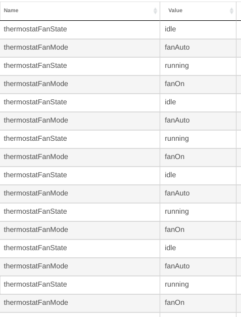

Maybe I'll go back and look at what you said... I am still not "getting it" I guess. I have tried 20 different things so far since getting home and I can never get things out of sync/incorrect on mine.
My fan state always shows running when running, idle when idle... So I'm missing something somewhere.
My logs... Every time... on, running, auto, idle, :

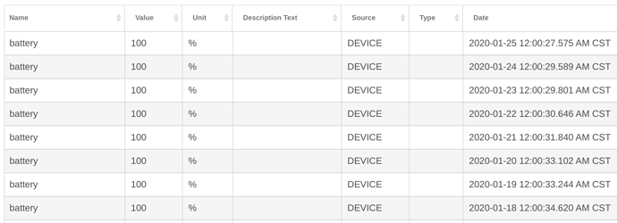

It's possible I'm missing something, but does this driver support battery level? I can see the battery level when I use the built in driver, but as soon as I switch to this one the battery state disappears.
It should show in the event log it after the thermostat reports a battery level the 1st time. Not sure if it will show as a state or not.
As you can see below, I got lazy and left the battery reporting on, even when it is hard wired. It reports 1x/day by default. So you should see it in the device event log at some point:
