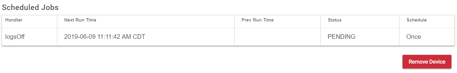

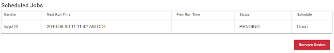

If you look at the device detail of the thermostat, do you see the poll scheduled job near the bottom of the device details page (that is where it should list any scheduled items). If you do, then Save Preferences will likely help. If not, then it likely won't.
If its there, it should be at the bottom, like this (although this is obviously the turn debug logging off scheduled task):
