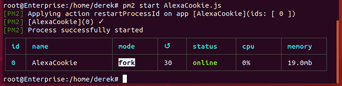

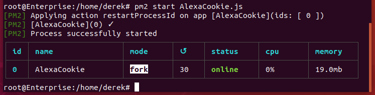

So I've installed node.js on my Unbuntu 18.04 LTS machine (Plex Server) and followed the instructions to the letter and it looks like it's successfully installed and running:
followed by:
  • Execute command pm2 startup
  • Execute command pm2 save
and I get command successfull etc .... but there's nothing on port 81 or port 82 on my system. :confused:
Has anyone got a more idiot proof guide that I can follow with troubleshooting steps? I just put the Alexa files into my /Home/Derek user directory becasue the guides linked to dont specify any file locations.

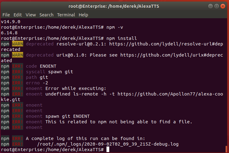

Just to follow up, I've been going thru this trying to solve the issue (including trying different versions of node.js) and the sticking point is always the "npm install". It throws this error every time and the App never seems to work as a result. :confused:
I've even tried modifying the package file to use the full URL without luck:
@gabriele I've logged an issue on Github as there is an issue with your script - I get identical results on my Unbuntu Server and my Synology NAS:

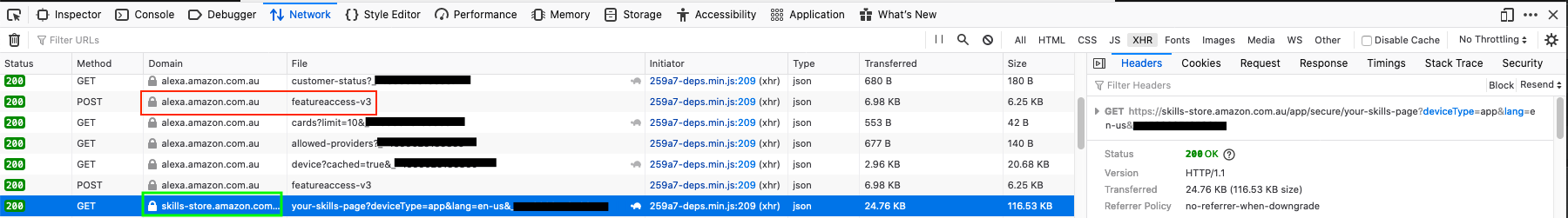

@ogiewon So after bashing my head against a wall to get the node.js system working and failing, I gave up for a bit and went back to investigating why the basic cookie option wasn't working.
Anyway, long story short, the Instructions on GitHub are wrong - At least for Aussie's with Mac's running Firefox.
You need to go to "https://alexa.amazon.com.au/spa/index.html#smart-home" and Instead of pulling the cookie from "featureaccess-3", you need to get it from "skills-store.amazon.com.au"
and then it will work perfectly.

Seems like “git” may be missing on your system.
