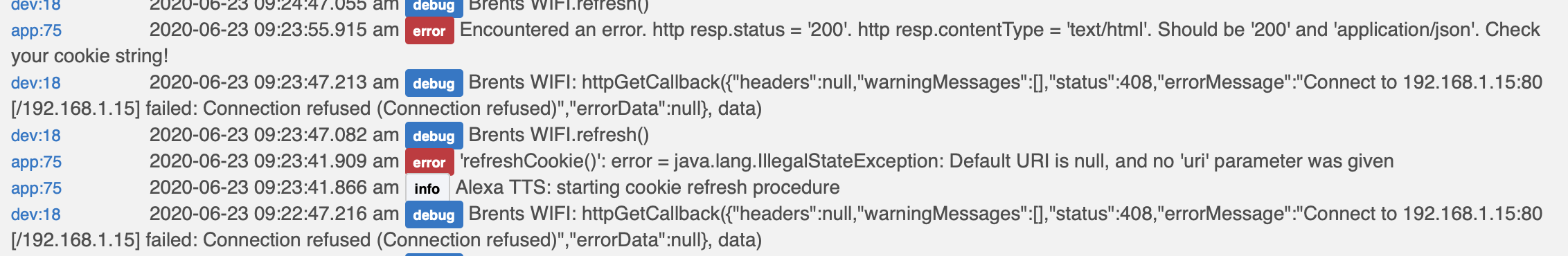

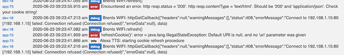

Hi everyone, I've been using the Alexa TTS for a bit in the beginning of the year and it was working flawlessly. I recently moved and now its not working im getting a "check your cookie" message and this comes up in the logs
How have you been renewing the cookie? Manually or using AlexaCookie.js? If it is the latter, then you should restart it daily (perhaps using cron) as described here:
I’m fairly positive I was using the one that refreshed on its own because after I set it up it ran without me doing anything for a couple months. So I can essentially just enter what is in the red circle at the end of the code? And which app would it be going into?
I didn’t even think about that but yes I believe it is a new IP address. Would I be better off just uninstalling the whole echo drivers and all and starting fresh?

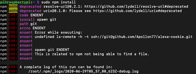

UPDATE: so I am an idiot. I am new to getting a raspberry pi setup. I didn't have git installed. once I did that, it solved the problem.

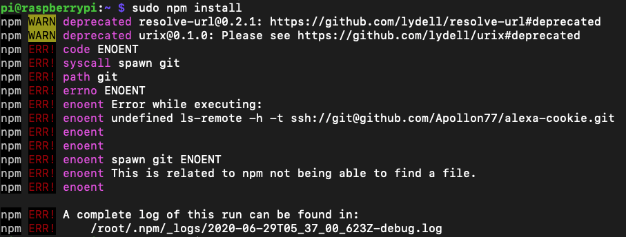

I posted this on Gabriele-V's GitHub page as well but I was wondering if anyone here had any insight.
I am in process of moving my homebridge and other node related applications from my Mac to a raspberry pi. I am trying to get AlexaCookie up and running on my pi and when I run "npm install" (with sudo), I am getting the attached error. It looks like the Apollo77 code base changed recently. Is that related?
