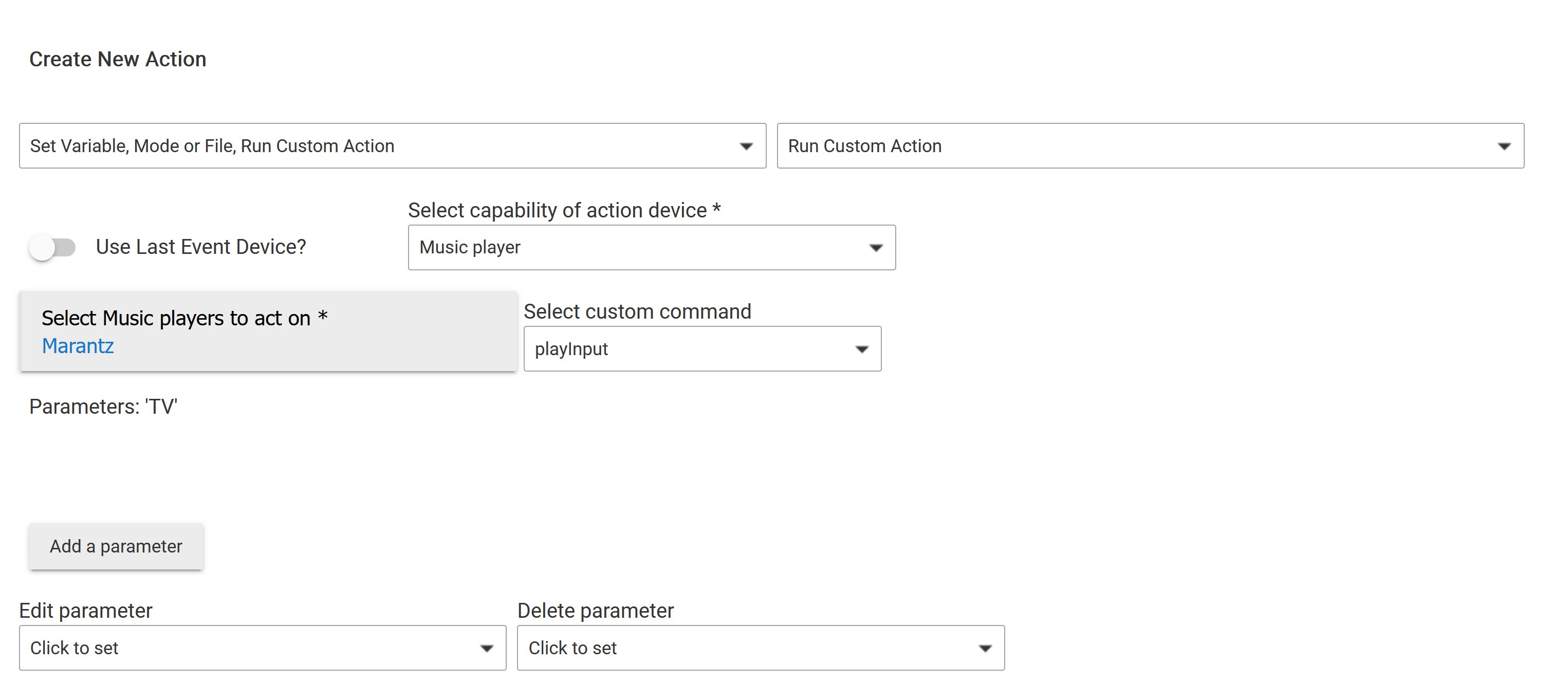

Thank you! I think I get the gist of what you are proposing:
ie - in apps, in rule machine, I make a rule for each input source (a rule for TV, a rule for CD player, etc). Then in dashboards, I make a button for each rule. Pressing the button would run the "rule" which is actually changing the input source. Do I have that correct?
If so, I'm afraid I don't get how to actually implement it on a dashboard. Any links or other info that would explain that part?

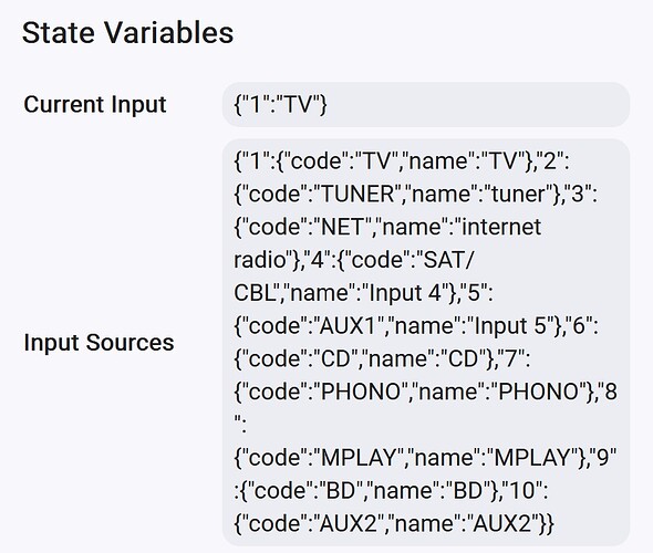

When I search HPM, a Denon driver comes up, but it looks like something different than @marktheknife posted - it seems to be for Denon speakers...
When I go my driver code and open the code for the Denon AVR Master Device, which is the driver I'm using, the beginning of the info matches the text @marktheknife posted, so I guess I'm using the github one...
