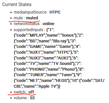

Denon AVR mute & switch States Not Updating
Denon AVR-X1700H
Fully updated C-7
All other Current States appear to update correctly.

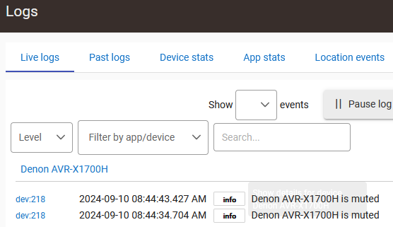

It appears the mute commands are detected but not the unmute commands. Only two Log entries after four presses of the mute button:
Power on/off does not produce any Log entries.

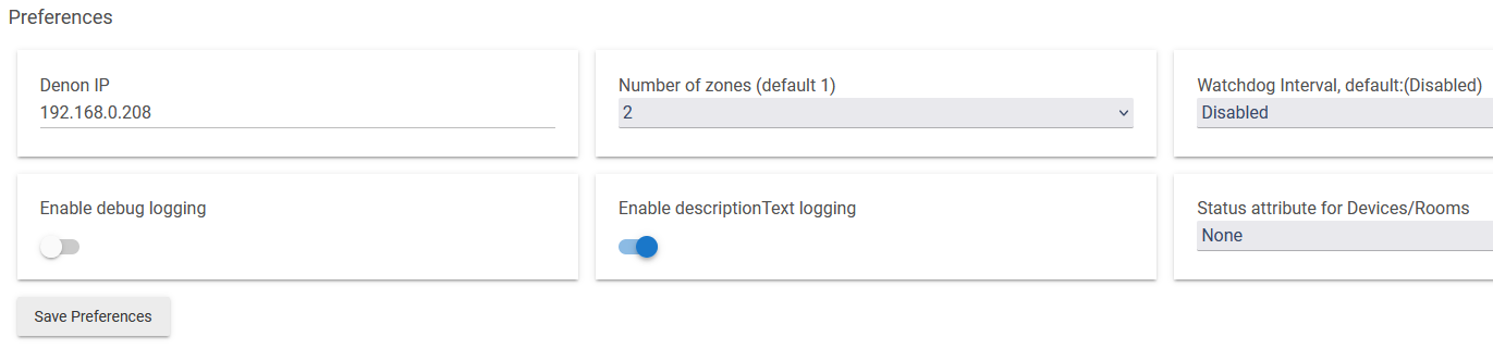

I would suggest power cycling your Denon receiver by pulling the power plug for 20 seconds and powering back up. Then go to your HE device and click the Initialize button to reestablish the telnet connection. Hopefully this solves the issue.
Reboot of Denon AVR didn't resolve the issue.
Do I need to set the Watchdog Preference?
I don’t recall ever touching that preference, but mine’s set to 5 minutes and the default is disabled. So I guess I must have.
Try it and see.
Mine is set to an hour. I remember this feature being introduced several releases back so maybe I set it up and forgot about it.
