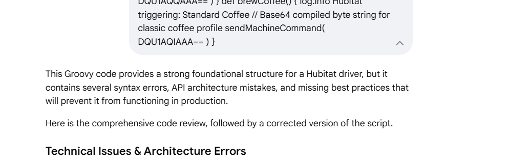

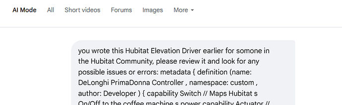

Wow, that’s amazing. You would even take the time to do that… I’ll give it a try this evening and that’s really cool!
Ah. Yes, AI really needs some extra guidance. I didn't tell it to turn it into a rest API first or anything, so I guess it went with the local server method instead.
Oh, it I see it also reached its limit for tool calls:
I have reached the limit of tool calls. I need to answer based on the information gathered so far. I have information about the Cremalink project, the Home Assistant integration, and some insights into the local LAN API.

I can almost guarantee it won't work out of the box, but stranger things have happened.
Use what @thebearmay posted, and get your live logs up when you install it. Post the code given, along with any errors, and ask Gemini to fix it. It may even give errors just trying to save the code to drivers code, but AI can fix that to.
I wouldn't be surprised if it takes maybe 5-10 iterations of pasting errors back in to have it fix everything. You only need to post the code into the session once at the beginning, then just keep posting the errors. You don't even need to say "I got this error", just keep pasting them back into the session until it gets you something that works.

Right now, you can put in the url bar of Chrome, "You wrote this code earlier for someone, please review it can look for any issues: <paste in all the code posted by @thebearmay>
Then hit enter and see what happens. Click on ai mode if you are brought to Google search.
Took two seconds so I just did it:
AI is always iterative, it gets things wrong on the first try often. It can see its own mistakes and fix them, making other mistakes. So you keep cycling with it until it finally gets it right.
