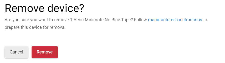

If you try to start the removal process from a Device page, you are prompted to follow the necessary steps to put that device in exclude mode. Can we assume you are following those instructions? As the example below (ignore the fact that they caps don't match HW, just trying to show the general flow):
2023-03-31 19_56_53-Hubs, Network, & Tech
Or are you trying to exclude/remove mains powered devices (e.g., light switch) that you have already uninstalled and so can't put it in exclude mode?
Just trying to get a sense of what you were doing/where you ran into troubles.
