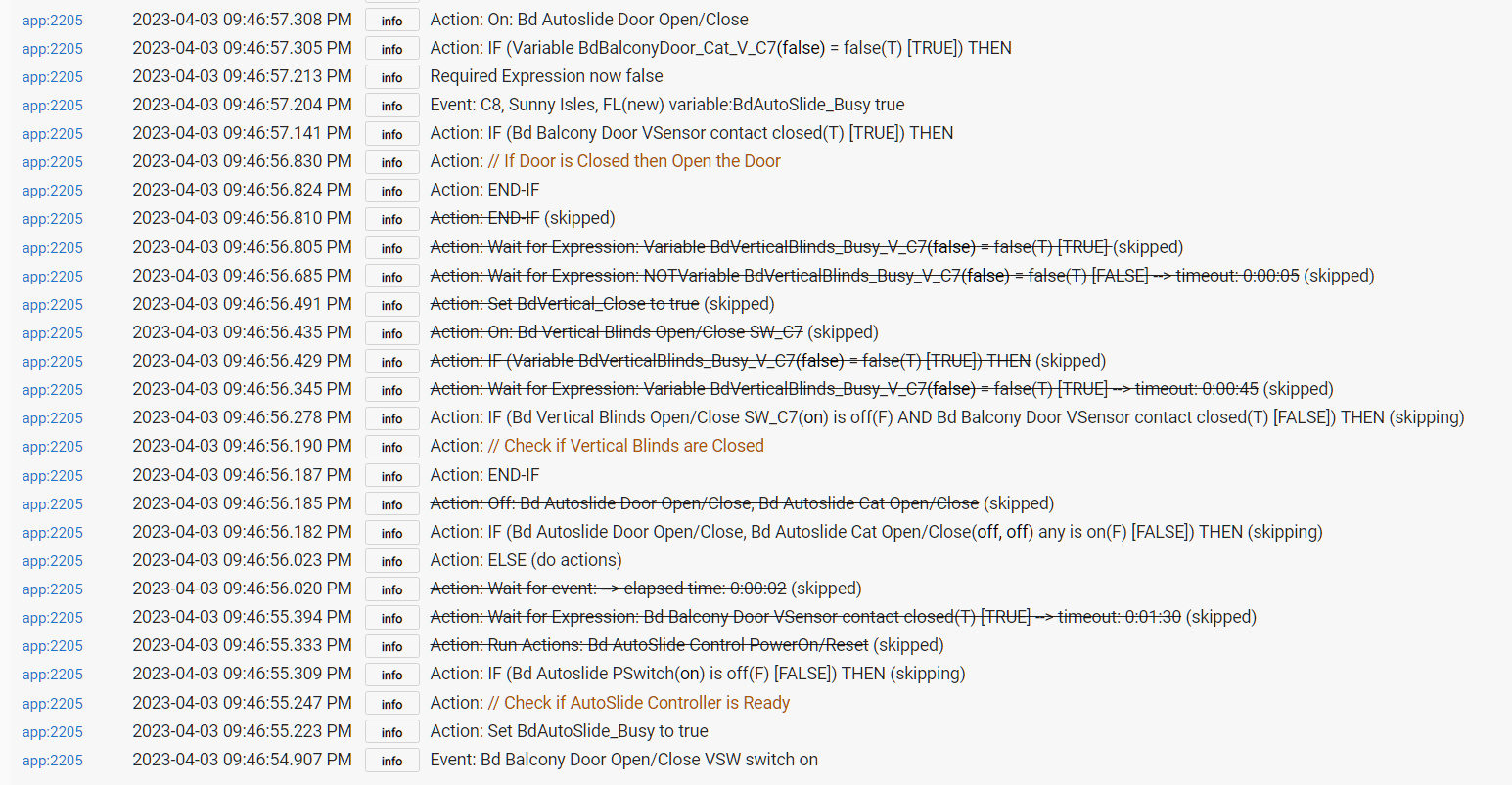

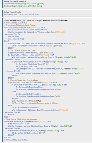

I have many RM rules using hub variables similar to Private Boolean plus for handshaking.
Here is one example.
At the very beginning this rule sets hub variable to TRUE "Set BdAutoSlide_Busy to true"
and reset it back to FALSE at the very end "Set BdAutoSlide_Busy to false".
This hub variable is used to prevent this rule from re-triggering and also is gating few
other rules (handshaking mechanism).

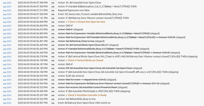

And here is a correspondent portion of the log (log truncated):
Variable is set at 09:46:55.223
app:22052023-04-03 09:46:55.223 PMinfoAction: Set BdAutoSlide_Busy to true
but correspondent event happens almost 2sec after at 09:46:57.204:
2023-04-03 09:46:57.204 PMinfoEvent: C8, Sunny Isles, FL(new) variable:BdAutoSlide_Busy true

Incidentally, Private Boolean should have better timing than what you showed in the log, at least with respect to the aspect of getting the Required Expression to be false. In that rule you showed, try replacing the Hub Variable with Private Boolean, and see if the timing is more to your liking.

Back to your problem shown above: Please try Private Boolean instead of Hub Variable. There will be no delay from multiple processes with this approach. Private Boolean is handled internally within the rule, and uses atomicState (written immediately). While this is not foolproof semaphore as would be required for true synchronization, it comes very close. This will at least prevent the multiple instance problem for most if not all cases.
