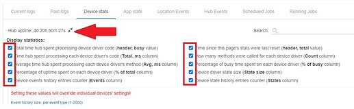

That doesn't look all that bad, especially for an app. It might be helpful if we could see all the stats for both Apps and Devices.
Click on the double arrow to the right of Hub Uptime, and select all categories. Repeat that for Device Stats also.
Screenshot each page and post here.
