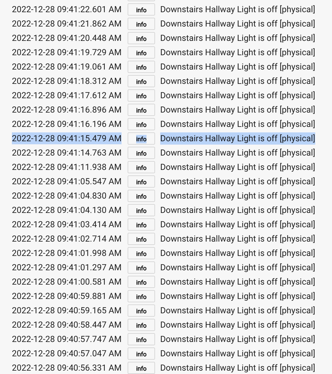

i have this switch that's spamming the log. Is the device dying? it's still controllerable.
What brand? GE/Jasco devices do this when the switch has failed. I just had one do this the other day and I had to replace. The blue LED was blinking.
Yup GE/Jasco... Replacement coming.. I can hear it clicking physical. Another died like that last week too.

Yeah when it rains it pours I guess. Just got another failure. Same thing.. clicking sound and log flooding. Must have been the recent wind stormthat caused power flickered the past few days.
