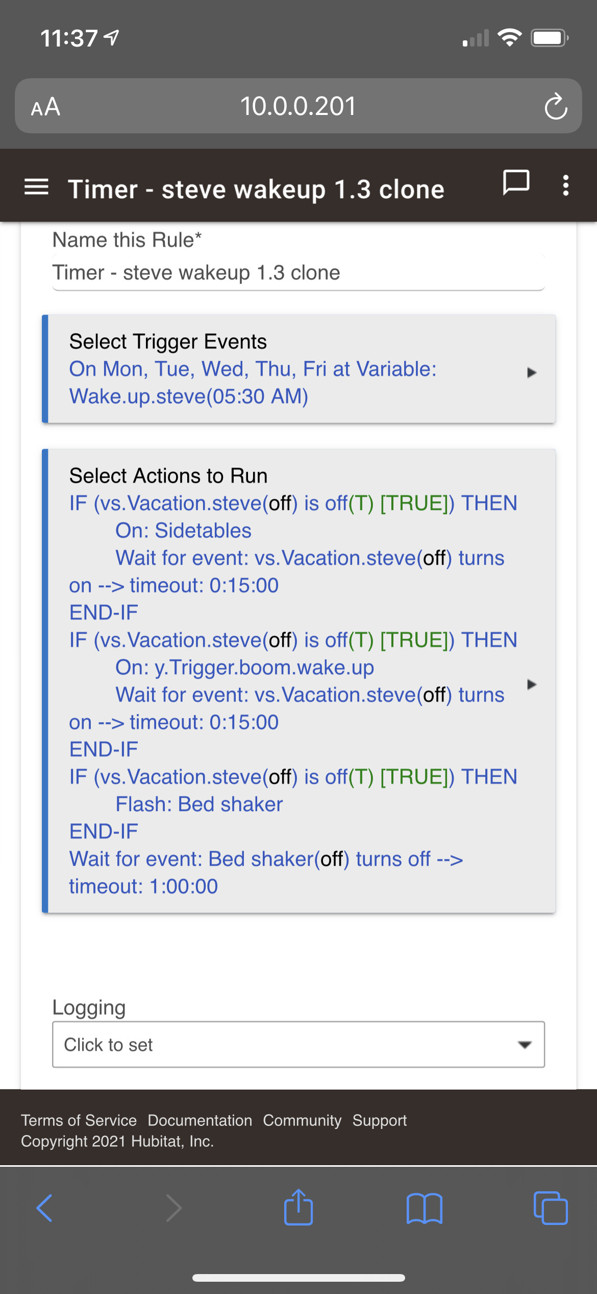

I have a RM4 that runs on weekdays at 6am and I went in to edit the time and it wants a time specified for Saturday and Sunday as well.

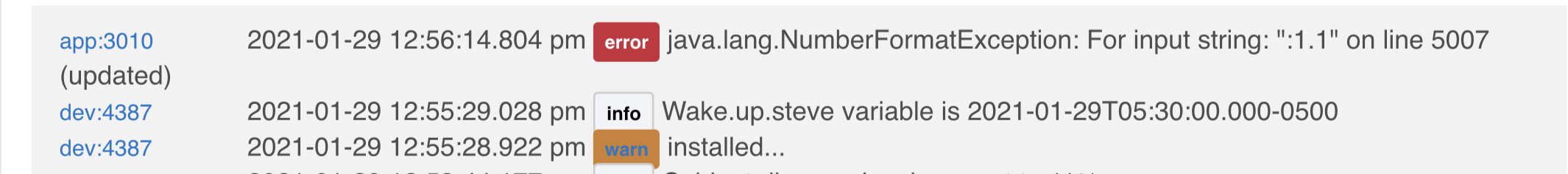

I hit done without specifying a time and noticed in the logs

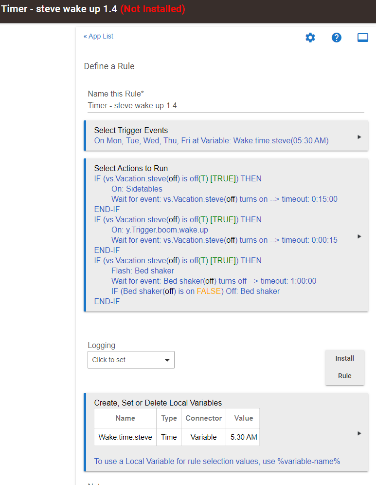

Please show the rule setup.

The rule I was editing was RM 4.0. I just cloned it and changed it back and I got the error again.

me again.
I just re-entered the rule from scratch. I hit install and get the error. i don't know what i did differently here than the quick test rule i did before. Can you see anything wrong with this?
That's the same bug as before, but in a different context. Fix is going in for it.... Next release.
