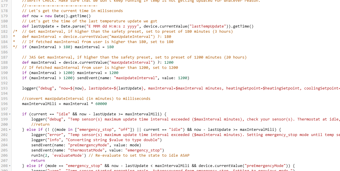

Here's one example - While fixing something in Advanced Thermostat yesterday I was working in this area - Take Note of line 179, 196 and the math on 198
That is essentially what I'm doing too.
Line 179, new Date().getTime() is the same thing as now()?
