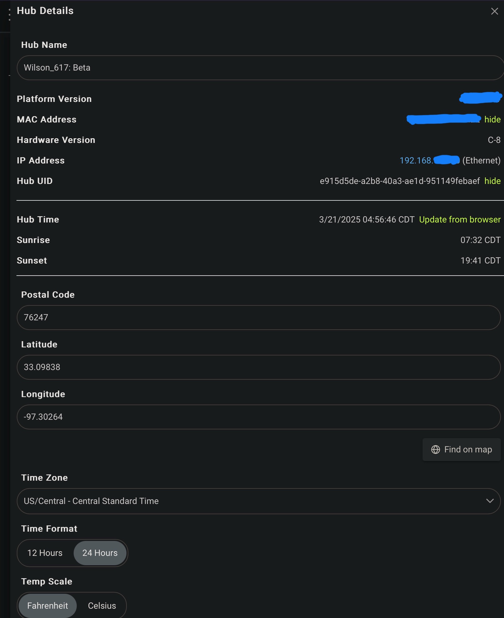

I’ve have been tinkering with Ai and trying to use it to help me learn some coding and have used it to help create a couple apps. One Is a date based app. Is there a way to change the date on a hub manually, and not get the date or time from the net? I would like to try this out now, not have to wait until November to see if it actually works,. Thanks!

That is where I’m getting hung up. Unless im missing somet, the only option i see is to update from browser.
From the thread @bertabcd1234 pointed you to, this is the line that does the update: :
You can set epochTime in the example to any valid value that you like and execute it. As he also mentioned you can disable the NTP server by sending the endpoint:
http://<HubIpAddr>/hub/advanced/ntpServer/<ipAddr>
an invalid server address.
