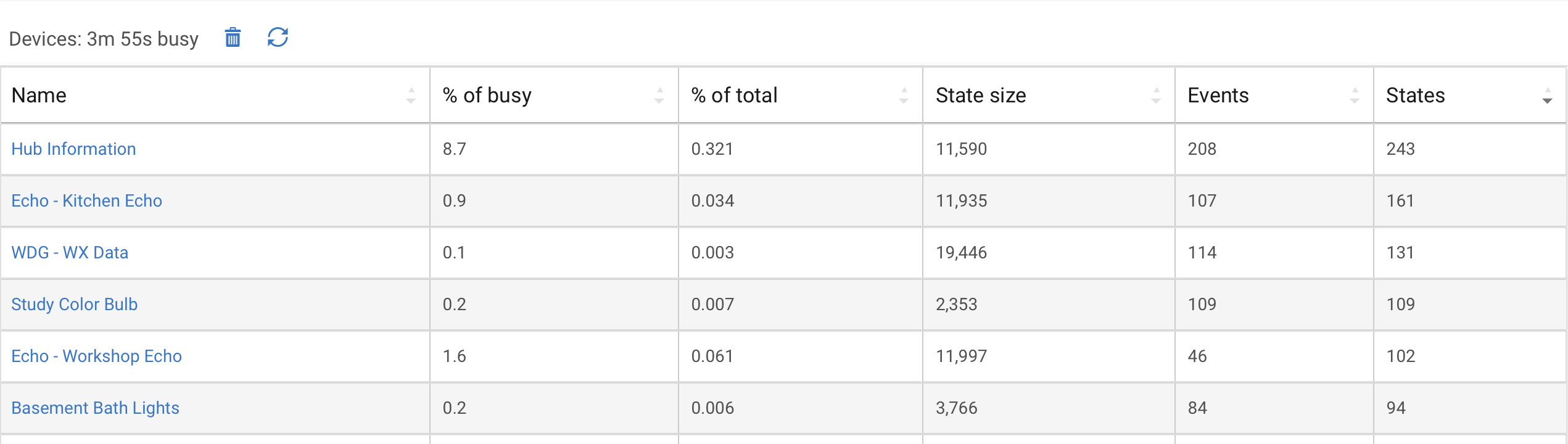

Devices:

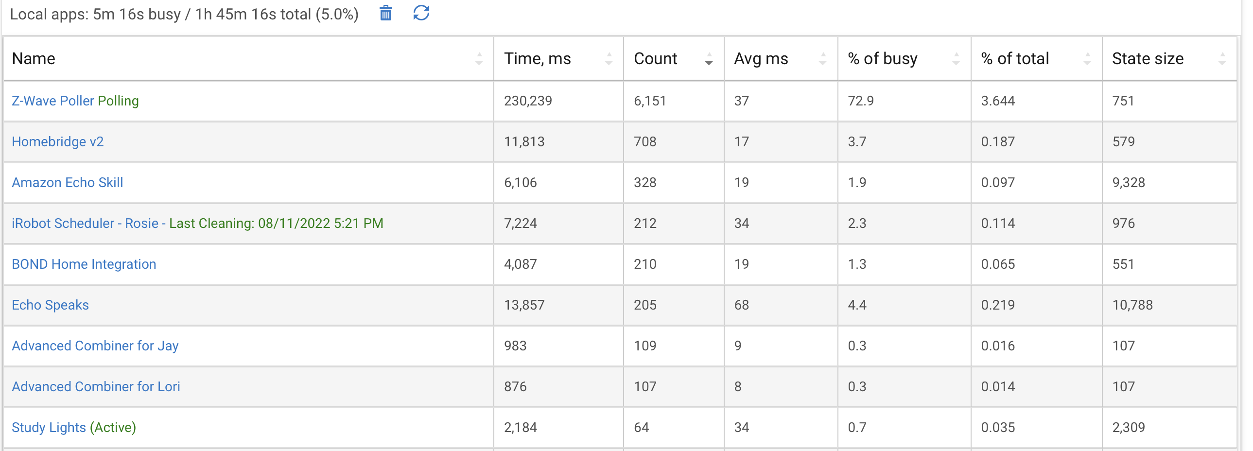

Apps:
Does anything scream out at you? Why? I mean if they'd say "hey, 23% of your db is made up of XX that would be great."
I appreciate the response though, I really do. Makes it look like Hub Information is an issue, though I added it to be able to view the growth of the database in the first place...
And while we're at it, with the settings at 11/11 why would we have counts over 11? It makes no sense. And I have logging turned off for Z-Wave Polling yet over 6000 events in the logs. It also makes no sense. These are some of the reasons why troubleshooting is perplexing!

That is 11 per state. So lets say you have weather app. It has temperature, humidity, cloudy, precipitation, barometric pressure, today's high temp and today's low temp. That would be 77 states for just that one app. And if that weather app had a 5 day forecast, and you kept days or weeks worth of history, it would surely balloon out of control. So for things like this, and other very data intense apps, I crank everything down to a bare minimum.
I would say start with Echo Speaks. I would go in and see if you could reduce the states and events on the individual ES devices. I set mine to 2 for each device.
Ok. I've cranked the echo speaks devices down to 1. Thanks. As I mentioned above, I already made the default 11/11 and max 7/7.
