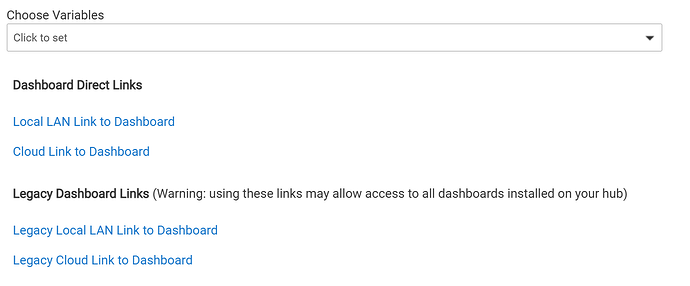

I think this maybe what you're looking for:
Apps > Dashboards > "Dashboard Name"
Copy Link

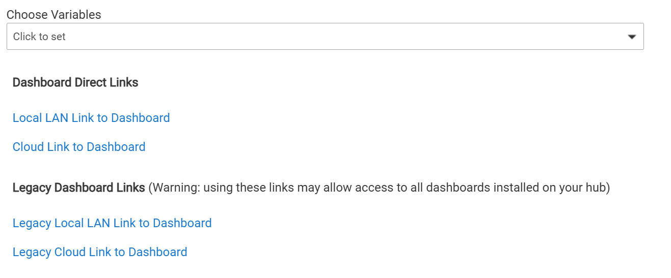

I'm trying to use the Hubitat app.
When I copy the link, it doesn't work, either because it's a browser error or the link only works in the app.
This way it works, I'm trying it directly in the hubitat app
I might be misunderstanding what you are doing. That said, it is either/or.
  • The link that msaeri shows above is used in any browser like Chrome. It isn't intended for use in the Hubitat app.
  • The app should connect to the hub whether you are local or remote without any workarounds or messing around with links. If you are on your home Wifi, it should connect local, and if you are on mobile data it should connect via cloud.

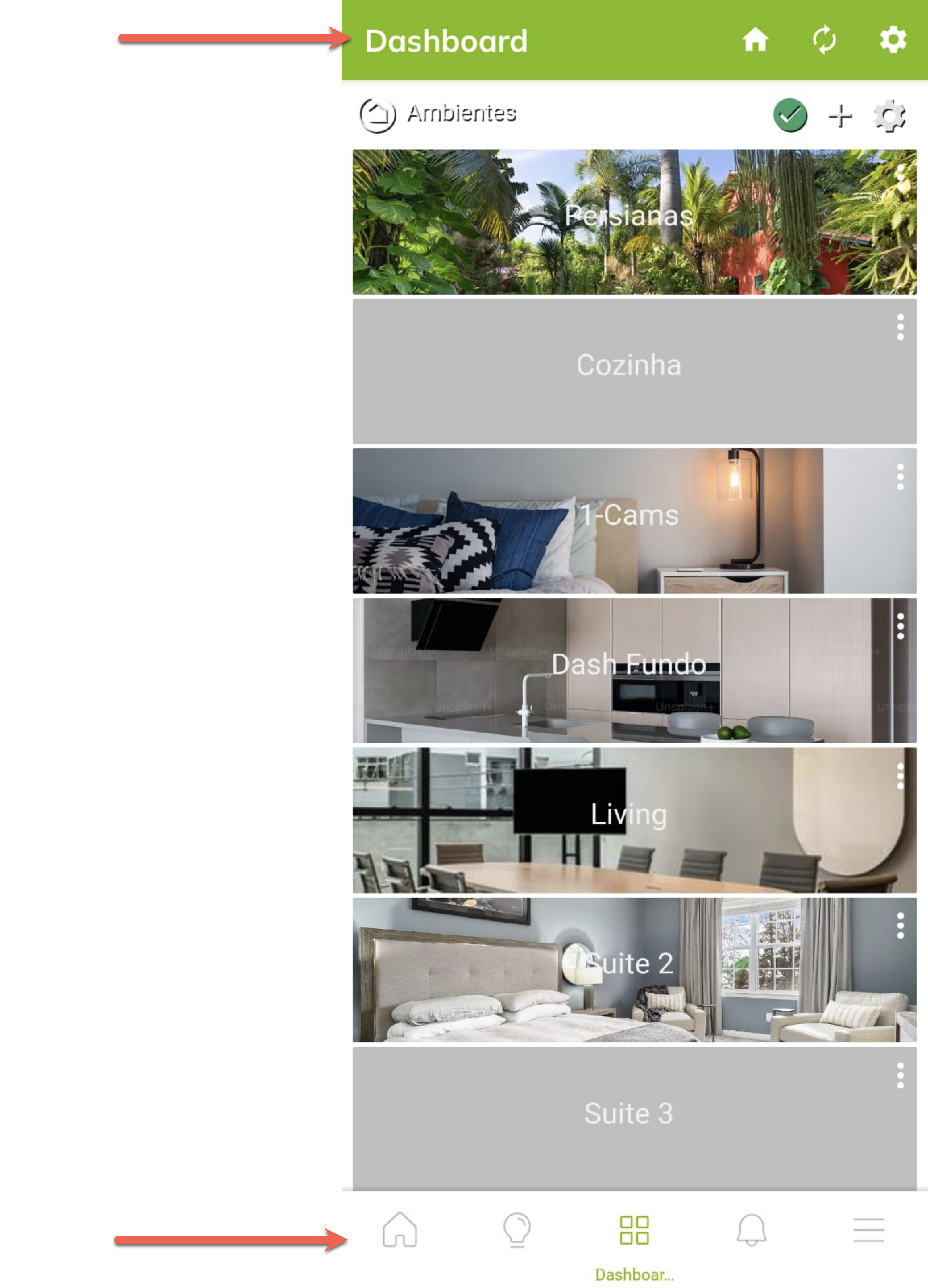

  • When in the APP, and inside a Dashboard, HIDE the top navigation "DASHBOARD - Home, refresh, settings). And bottom navigation. (this will give the same experience as in Chrome/Safari URL).
Maybe this can be configured from the "App Settings" option in the APP configuration.
"Hide Top bar"
And even select which Links are displayed in the bottom menu.
If you leave everything clean for the customer to only use the dashboards, that is what they will use. But if you leave the Home Link, the Devices Link, and the dashboards, sometimes they show the same devices, end user won't know which one to use = confusing.
So I believe that the best thing would be:
Always show the "More Options"/Settings.
Have a Hide/Show:
  • Home Link
  • Devices Link
  • Dashboards Link
  • Notifications Link
  • Enable/Disable notifications of new features when opening APP. (End customer does not care about this, and it's 3-4 extra seconds it takes for the user to do what he actually wanted, control the lights)
