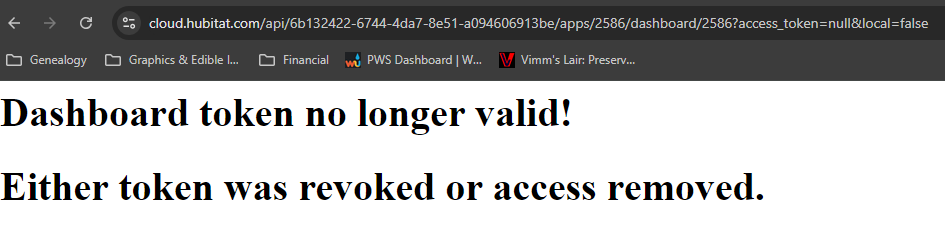

Hello,
I am getting the error attached when attempting to use the cloud dashboard links from the main dashboard page.
Thank You
Matt

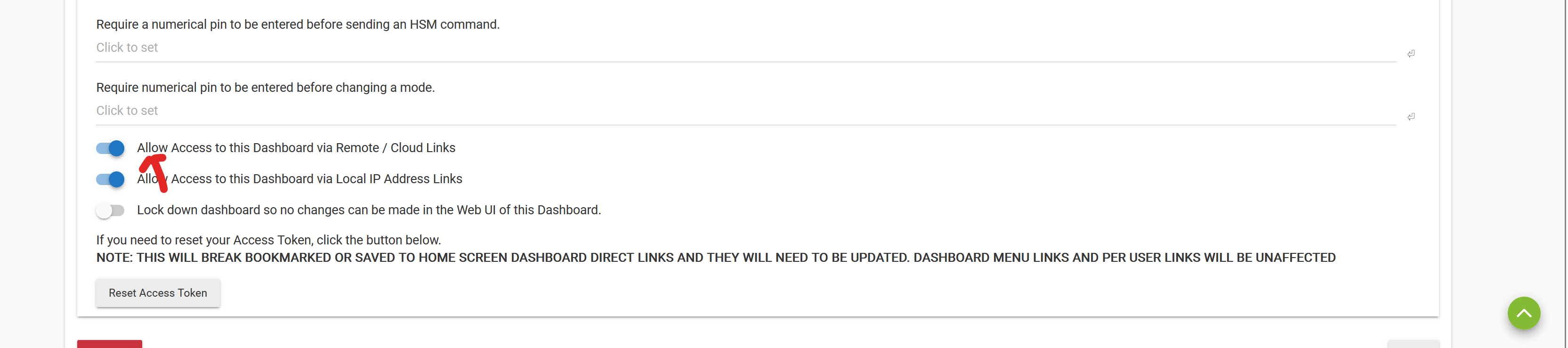

under yourhub>>Apps>>hubitat dashboard pick the dashboard and make sure it has access to the cloud..
Weird, it was checked but I had to reset the token for them to start working again.
Thank You
