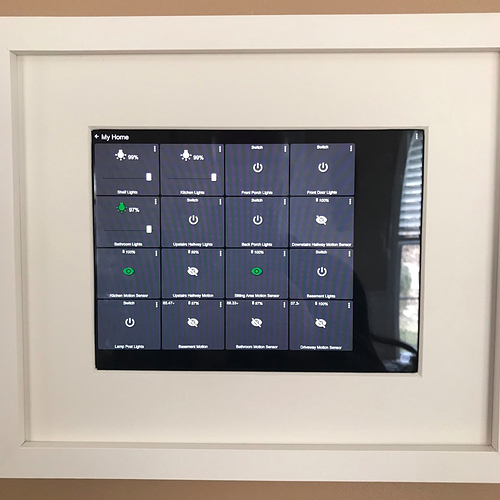

I'm trying to configure my dashboard with a second generation 9.6" iPad that I have hanging on my kitchen wall but the tile size is too big. I can only get a single page screen grid of 4x4. I was using this same tablet before with ActionTiles and had a 9x6 grid (9 columns, 6 rows). It also seems that Dashboard does not know that the iPad is in landscape mode. Adding a column results in a row being added. Which would be true if the iPad was in portrait mode. Any ideas on how I can get a 9x6 grid to work on a single screen with the Hubitat Dashboard?

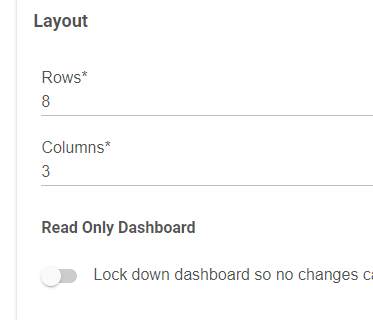

You can change the grid size to whatever you want in the options for the dashboard. Just click on Layout Options.

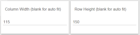

I primarily use this with my iPhone and found that adjusting the column width and height in the Dashboard Options tab I got my dash to fit nicely on my iPhone. Not sure if this helps but thought I'd toss it out there.
You can remove either or both for autofit as well.

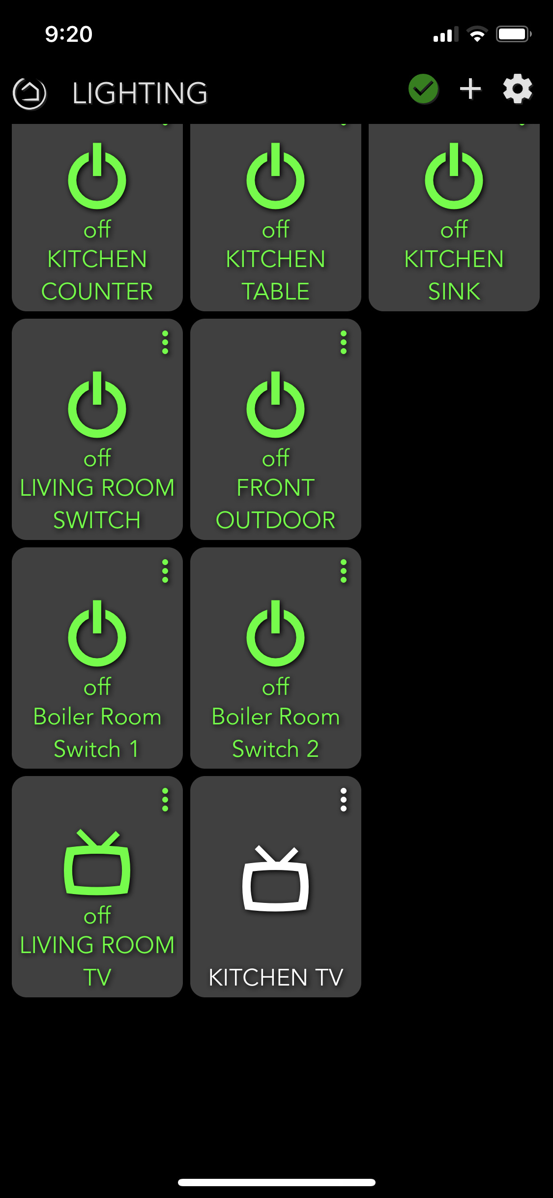

Used those settings to get this screen for iPhone10, fits nice, not so much with blanks.

Go into a dashboard, and in the upper right corner there is a gear icon.
In the first "tab" you should see number of columns, rows, font size etc.
In the next "tab" (black bar at the top) it says Options. This is where you get to set row width, height, and so on. I usually have a fixed height, but clear (no entry) the width. That will autosize for width, but keep a reasonable aspect ratio.
