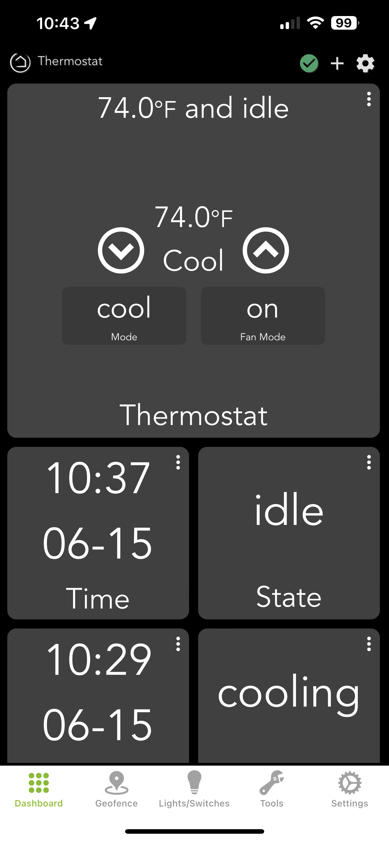

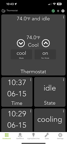

This is really close. I have this working pretty well.
Only two things that are sticking out at me...
  1. The tiles are really big. I guess this is OK, but envisioned the text being smaller and in more of an excel format all on one tile. This one I can get used to though.
Edit - I have %now% %date% seeming working as expected now.
  1. %now% returns only the time. Is there somewhere I can get a list of built-in variables (like %now%)? My hope is to find a date equivalent for %now%
Can you share a screenshot of what you ended up with?
There are apps available that will combine data into a single button. I’m not sure however if any of them will support using variables…

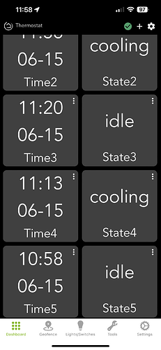

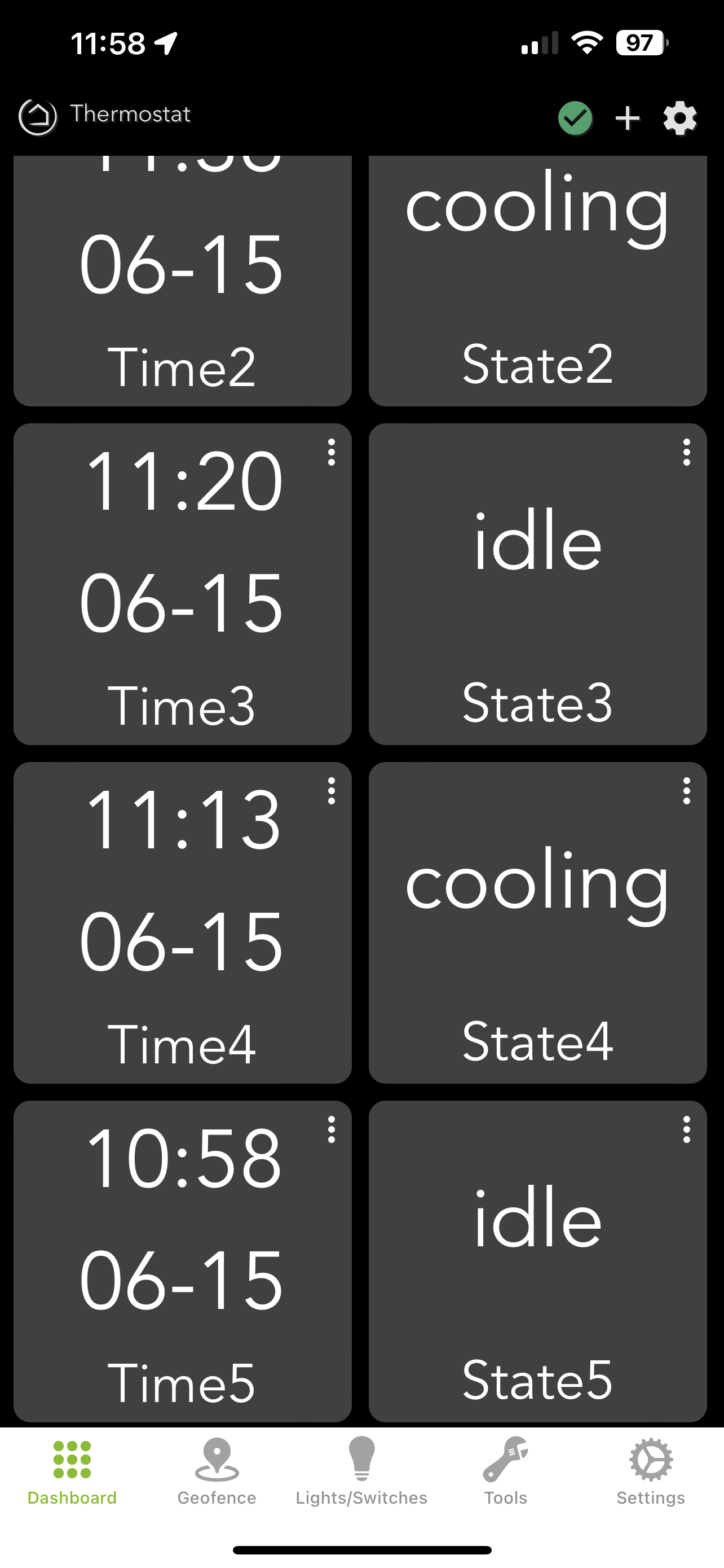

Time/State is the start time of the current status.
As I scroll down, the date is going back in time.
Don't pay attention to the times as the screen shots were taken at different times...
I can tell that the AC seems to be cycling too quickly, so I am going to try to tame that with some controller logic.

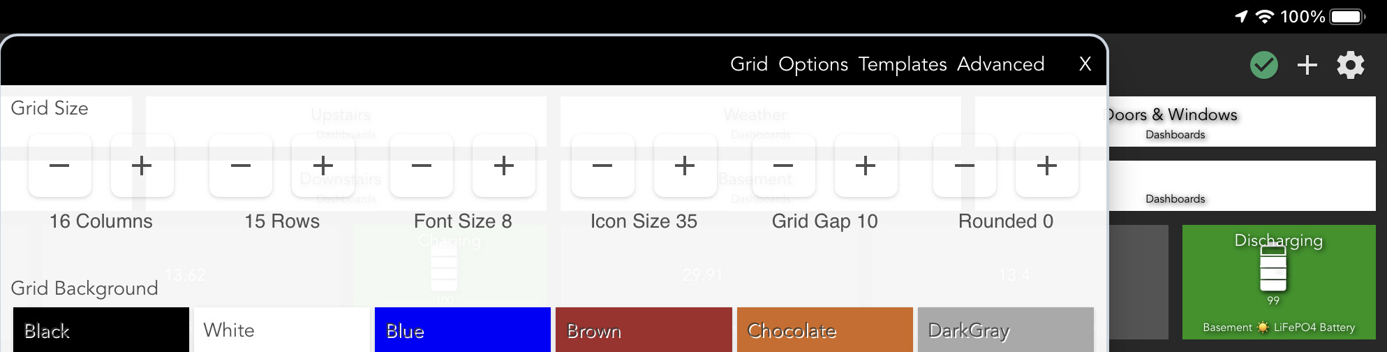

I would try reducing the font size as a starting point - see if that helps:
Settings (gear icon) -> Font Size
Changing the font size makes the control tile look really weird.
I would love to be able to change the font sizes per tile. That would make all tiles (not just this Dashboard) look much better. As it is, I picked a font size of 32 as a balance of the control tile text looking too small and these log tiles text looking too big.
