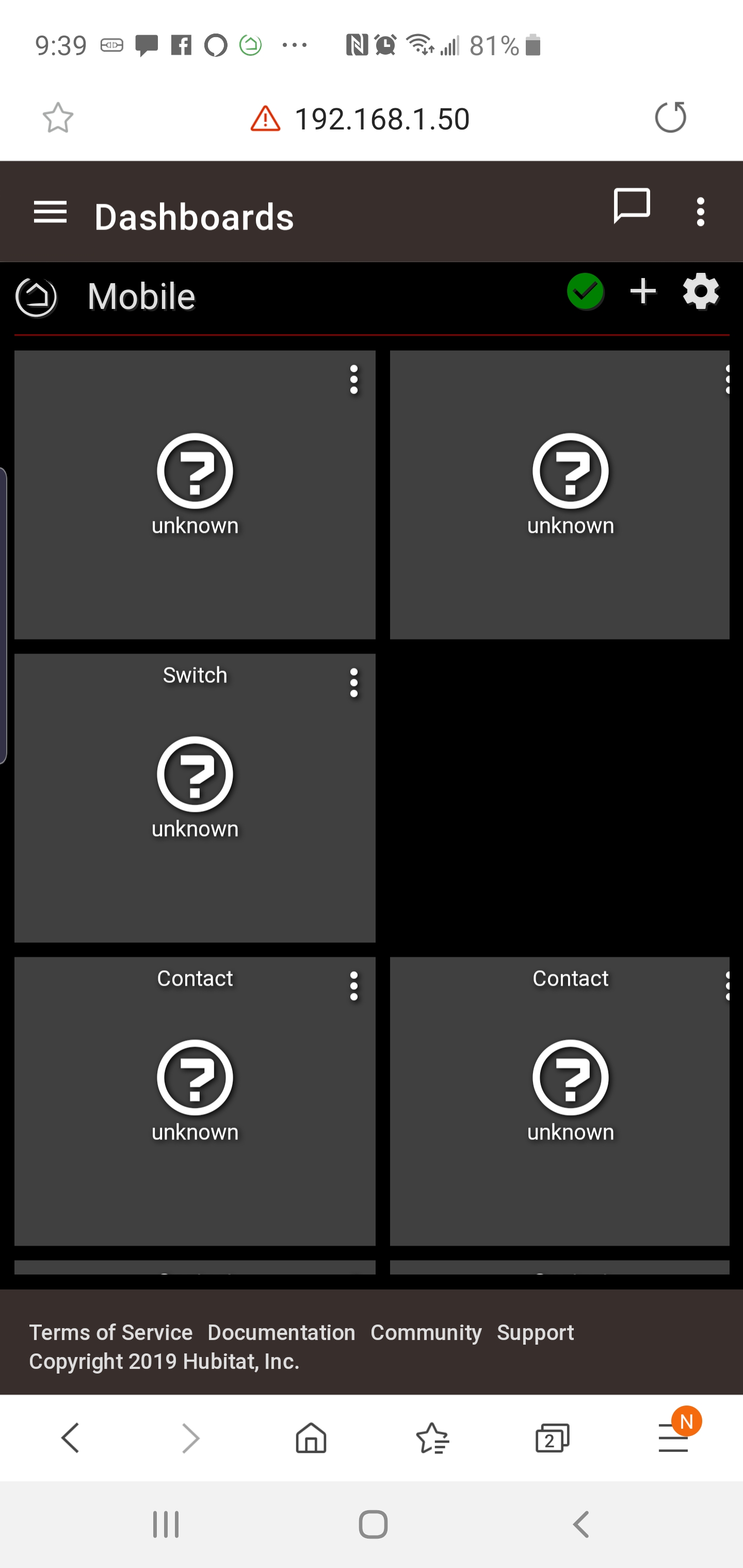

Why does my dashboard looks like these, I build it last night and it shows everything working, today everything has question mark but the devices are working. I rebooted the hub but nothing change.
That's odd for sure. Sounds like something didn't load right. Does it do that on a refresh? Also in the gear, advanced, devices, is anything listed there?
I've seen this on the odd occasion. Toggling the switch in question resolved it.
If you click devices in that area does it show the list of devices authorized and do they have states?
Does this happen on a different device or browser?
It looks like you might have turned off the authorize all devices and didn't authorize the devices originally added on the dashboard.
Hey @patrick that did it, it somehow turns off all the authorized devices for that new dashboard. Everything is working on the Dashboard. I have a few more questions as I'm moving everything from my wink to the Hubitat and some light bulbs (GE LINK) are not working but I will open a new thread for that issue.
