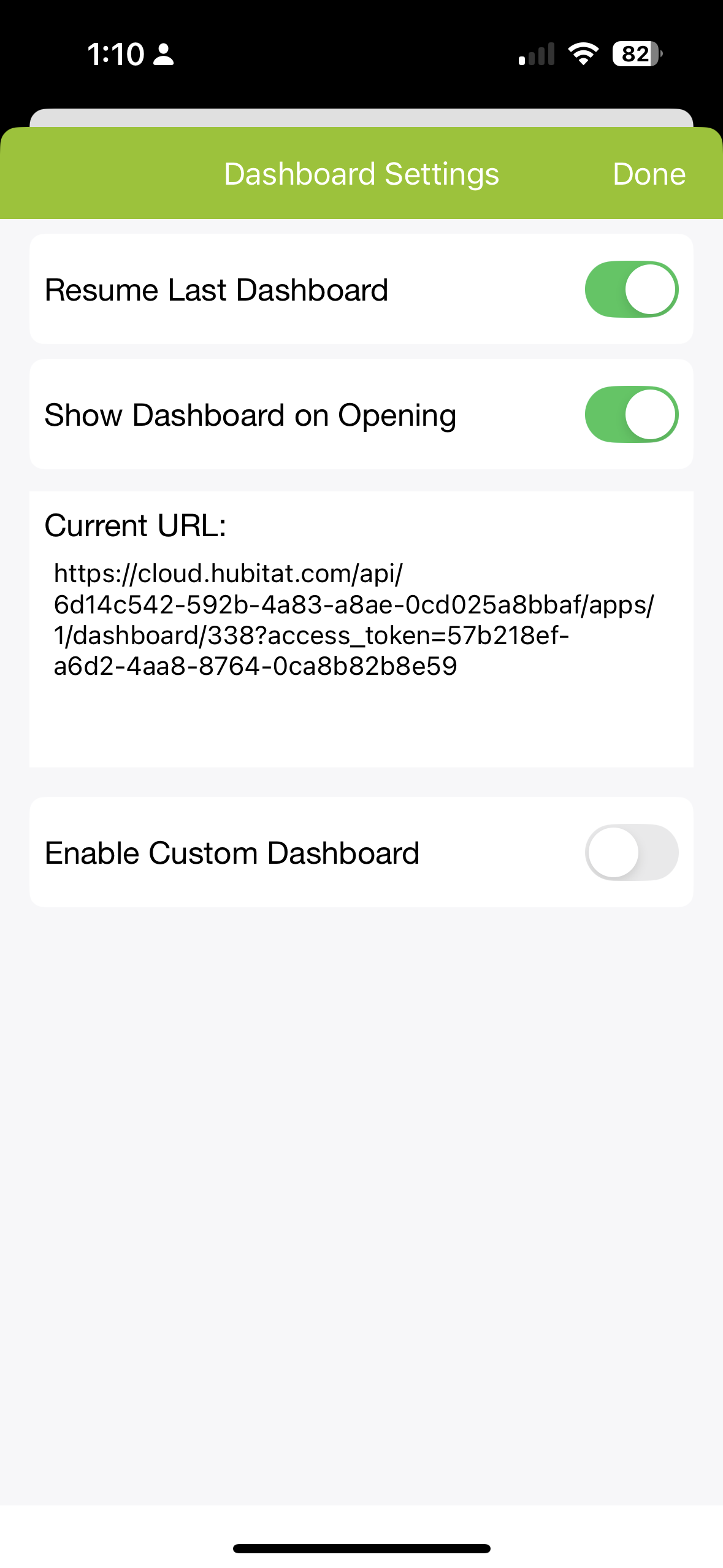

It has, but I only found the solution to the issue coming back in the latest release by accident the other day.
Tap on the gear icon in the top right of the dashboard and turn on “Resume last dashboard”.
The default is off.
