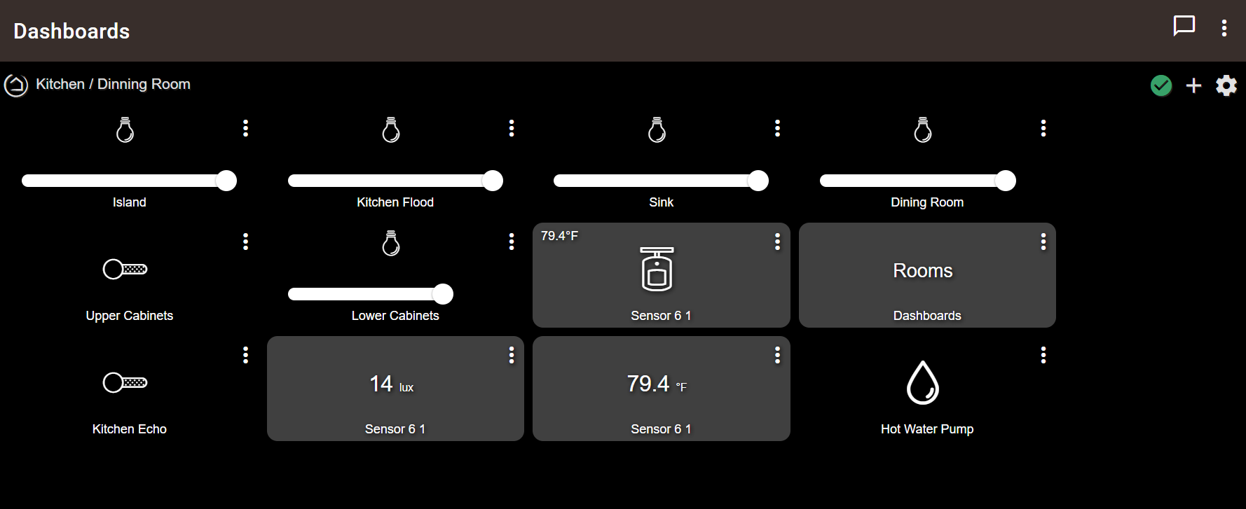

@arnb and @bobbles I only have a few devices in each as shown here
. I have not created any of the dashboards with all devices as I do not want anybody in the house to have access to most of the devices I have on the system.
OK. But have you selected only the devices you want to expose to the dashboard.
NOT "Use all your devices".
You may lock down the dashboard by
  1. Display the dashboard, Click on the Dashboard gear, click Options, check Hide 3dot menu
  2. On The main He menu go to Apps, tap/click on the dashboard name, scroll down, open advanced dialog, set ON slider for "Lock Down Dashboard...."
@arnb and @bobbles Thanks I had the use all devices slider on. I am going through each and selecting only the devices in dash. Thanks for the direction!
