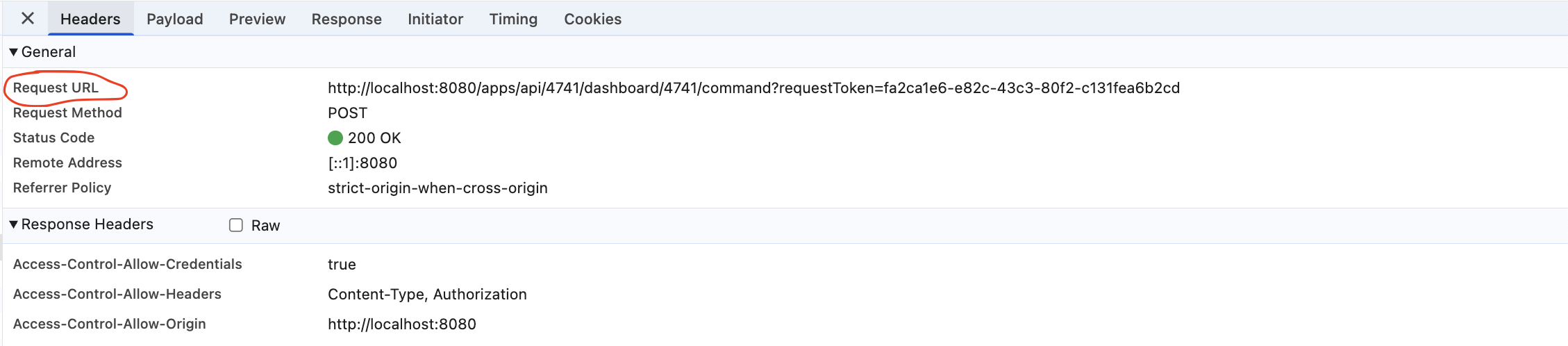

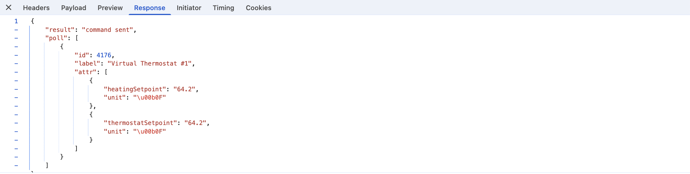

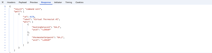

If you bring up developer console (usually with F12), does the JavaScript tab show any errors?
If there are no errors, can you switch to Network tab, issues a command, and post these two screenshots?
I've seen occasional reports of this issue, but can't reproduce it locally.
Also, could you please PM me you hub's id? I'll check the engineering logs.
